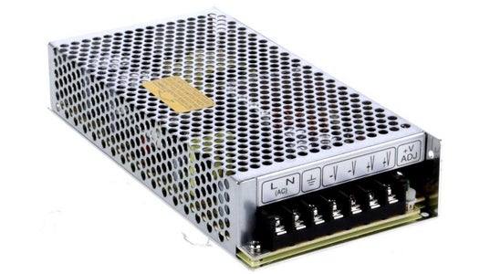

Space was always going to be a premium in this project. I had to power 8 Raspberry Pi 4’s at the recommended 3A per Pi. That would be a recommended 24A at 5V which equates to at least 120W. I found this Mean Well switching power supply that could deliver up to 26A at 130W.
For the network switch I needed a simple 12V 1.5A power supply but I wanted something that took up minimal space. For this I used the extra slim HiBay 18W 12Volt transformer. I ordered a DC barrel plug cable with it.
For power going into the case, I used a simple kettle plug switch with leads and fuse. This made it neat as only one cable into the rear for power. Also triples the fuses, one in PSU, one in switch and one in kettle plug.
