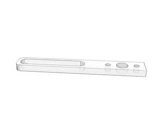

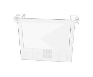

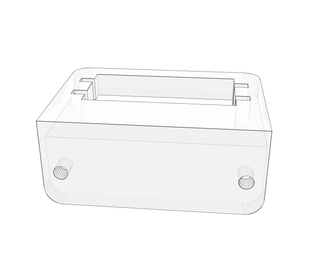

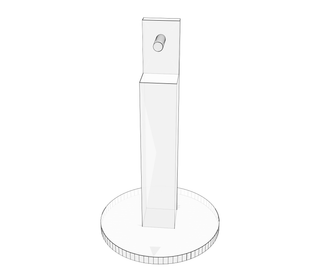

There are several 3d printed parts involved and I have included the Fusion 360 design files as well as the .stl print files.
The servo connector should be printed at 100% fill--everything else is your choice.

Attach the servo connectors to the servo horns.

Insert the lifters through the square holes in the base unit.

Fasten the servo holders to the wood stand before securing the printed base with screws.
