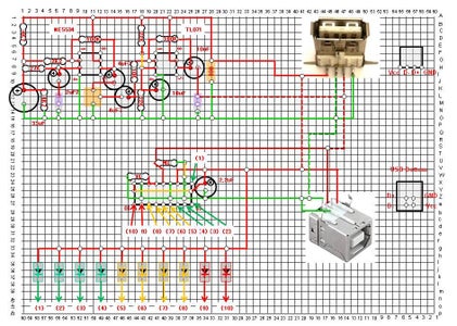

Step 1: Schematics
Among the two SLM variants, the miniature version's schematics are the exactly same as the prototype version.
But the other variant (I'll call this new device as MIC/Display modules version) uses the same schematics with divided circuit modules and their connection with the USB cable as shown in the picture above.
As the MIC should be located right in front of the speaker, the main SLM circuits (pre-amplifier and LM3915 display module) are also located near the speaker.
When connecting wire between MIC and pre-amplifier becomes longer, the input signal can be weaker, and a long connection wire can receive RF signal as interfering noise.
Also, suitable space should be reserved near the speaker for locating SLM main body.
To remove MIC and pre-amplifier wiring dependency, overall SLM circuits are divided into modules as follows.
- MIC/pre-amplifier circuits are integrated as a single module
- 9V power is supplied via (+), (-) wires of USB cable from display module which including the LM7809 voltage regulator
- Captured weak audio signal by MIC is multiplied by pre-amplifier into several hundred mV to 1~2V and transfer to LM3915 display module via (Data +), (Data -) wires inside the USB cable
By dividing overall SLM circuits into two modules, you can easily locate MIC near to speaker and place the display module in any location you prefer.
Above is the main reason why I'm making the MIC/Display modules version.

As a separated MIC/pre-amplifier module is made, the original wiring diagram should be modified for making a smaller circuit footprint on PCB.
Also smaller and general-purpose capacitors are used for this project.
