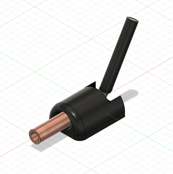

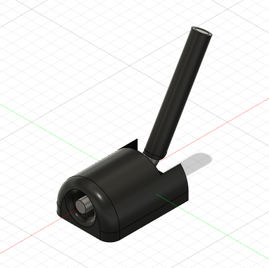

      Step 22: Feet Feet Are Electrical Plugs
      An electrical connection is established because two wires are pushed into the same copper tube. This is disguised by the feet where the end of the wire is threaded into the foot till it just peeks out the front. The copper tube is permanently glued into the front foot. When you want to join ants you push the copper tube embedded in the front foot over the other wire and into the back foot. Friction should keep the feet together and the electrical parts insulated.
      Front footBack foot
      Front FootBack foot

      Step 27: Using Wire Glue
      Stir the glue well before using. It will flow easily off the stirrer when fully mixed.
      There is a small tray at the rear of the 'foot'. This will help keep the glue in place.
      Before glueing make sure that the hole for the wire is clear by poking the foot wire through it.
      Step 28: Glue Foot
      1. Dip wire foot in wire glue.
      2. Slip wire foot through back of the printed foot.
      Step 29: Check Glueing
      The tray should fill with glue. If not use a toothpick to add more glue. You can heap it so that it matches the round part of the shoe.
      Step 30: Add the Copper Tube
      This only applies to front feet.
      This diagram explains how the components are designed to go together
      Step 31: Glueing the Copper Tube
      Dip the end of the copper tube in wire glue as shown, get just a little bit on the end.
      Insert the pipe into the foot, over the wire. The wire already in the foot and must go through the centre of the pipe. You may have to gently move the foot so that the wire is in the centre and the pipe slides over it.
