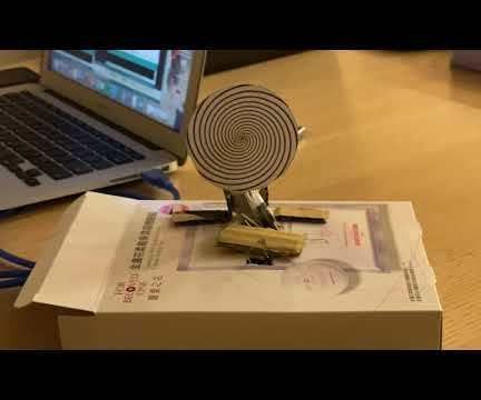

Step 2: Build the Product
1. Choose or make a box that is about 21cm x 12cm x 11cm large. However, the size of the box can be customized.
2. Stick the Arduino board and the breadboard at the bottom of the box. Make sure the breadboard and the Arduino board won't wobble around, or the jumper wires might fall off the port.
3. Cut a hole that's about 2cm x 2cm large outside the box. This hole would be the place where the USB cable will pass through to connect with the Arduino board when the other side of the port is connected to the computer, so the cable won't get tucked when you're using the monitor.
4. Cut Another hole that's about 7cm x 2.3 cm large. This would be the hole where you place the LCD screen. The hole is designed to let only the screen to appear. After sticking the LCD screen into the hole, add some tape and stick the LCD screen on the interior of the box.
5. Cut the third hole on top of the previous one. The hole should be about 4.5 cm x 1.5 cm large, and the Ultrasonic sensor will be placed into the hole. Then, add tape at the back of the sensor, and stick it on the interior of the box.
6. Connect the jumper wires to the LCD screen, LED lightbulb, and the ultrasonic sensor. Refer to the Circuit diagram on the top.

After finishing uploading the code, the result you should get should be the same as the photos above.
Step 4: Decorate the Monitor
Decorate the Monitor with papers, tape, scissors, etc. Make it whatever you want it to look like! Once you finish decorating and sealing the box, the work is done!.
