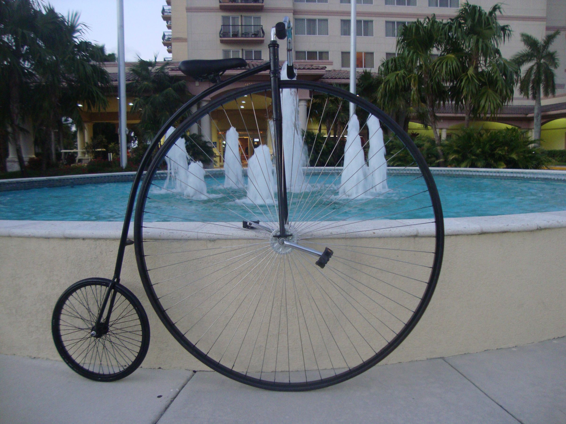

Introduction: Antique Bicycle
Picture yourself riding one of these, and you will be the talk of the town.
Here I'll show you how to build your own antique bike like the Ordinary Bicycle,
also called a Penny-Farthing -- common in the 1880s which became an
iconic symbol for transportation history.
With an old bike, a few tools and materials, and some patience, you can
build this bike and bring history to your front door.
Although replicas and originals can cost thousands of dollars, yours does not have to!
I'll also teach you how to ride it!
So get your tools out, find an old bike, and let's get started!

My welded rim measured approximately 48" in diameter...
I guess 26" rims are really smaller than 26".
As a guide, I measure 5'6" and the 48" rim reaches up to the bottom of my sternum.

The picture shows the bike already painted but when welding the step, as in all welds,
the metal should be sanded down and clean.
Now all that remains is a paint job.

Riding an Ordinary Bicycle is a most exhilarating experience!
You stand only 2 feet above the ground but boy oh boy do you feel tall!
