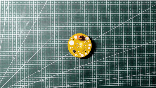

After the schematic was converted into a PCB design, all of the components were then arranged inside a 50mm-diameter circular board shape.
All of our leds were placed in the center, and the other components were arranged around them.

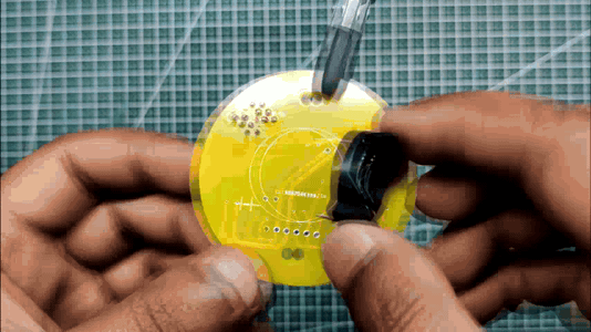

Step 3: PCB Assembly
Two main parts make up the PCB assembly procedure for this project: first, we add SMD components, and then we insert THT components.
  • We begin by applying solder paste to each component pad individually using a solder paste dispensing syringe.
  • Next, we pick and place all the components in their proper places using ESD tweezers.
  • Following the pick and place process, we place this board on a mini reflow hotplate, which heats the PCB from the bottom up to the solder paste melting temperature.
  • We now add the switch in its place and solder its pads using a soldering iron.
  • Next, on the bottom side, we add the CR2032 coin cell holder to its location and solder its pads from the top side of the board.
Board assembly is complete.

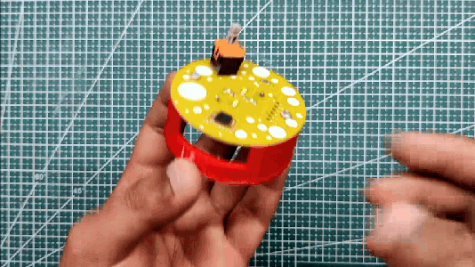

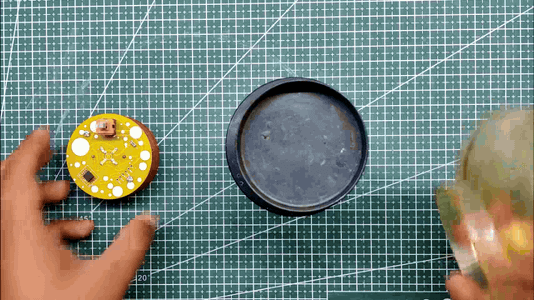

Step 6: 3D Printed Circuit Holder
  • We had to design a cylindrical PCB holder that lifts the PCB and keeps it inside the top glass body of the lantern in order to hold this circuit inside the body of the lantern.
  • Red PLA was used with a layer height of 0.2mm and a 0.4mm nozzle to print this part, which was created in Fusion360 and exported as an STL file for 3D printing.
  • To install the circuit on the 3D printed portion, we need two M2 screws.

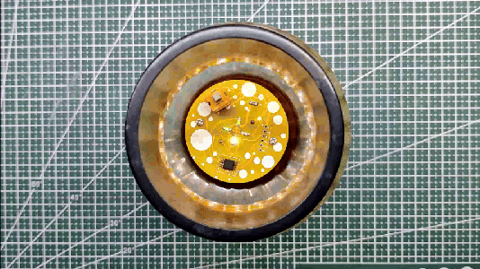

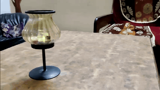

Step 7: RESULT
Ultimately, we assembled the lamp by only placing the glass top on top of the metal lamp frame and the PCB Holder Assembly Section.
The project is finished, and we now have a vintage oil light that employs modern tech.
Green and white LEDs were utilized in this project; red and orange LEDs would have produced a much greater flame effect, but I didn't have those at the time, so white and green LEDs were used instead.
Overall, I'm satisfied with the outcome, and my dining room now features a stunning lamp.
