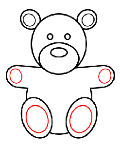

Step 3: Trace the Bear
In this step you need to do two things. The first is to cut out the template of the bear that you should of printed out. The second thing is that you need to trace the outline of the bear onto the wood so you have a clean line to cut on.
