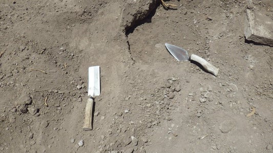

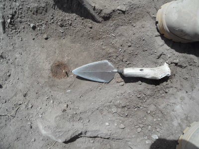

As an archaeologist, I use a trowel a LOT. A few years back, my dad made me a custom trowel with a stag horn handle. I absolutely love that trowel and in the years since, I've made a few others. I get a lot of compliments on these and people often ask me how I made them. The techniques I use here could be used for all sorts of things, including knives, silverware, and BBQ tools. If anyone has suggestions, I'd love to hear them, as I'm sure I'll be making more of these in the future.
I didn't know about Instructables when I made these, so I don't have any in-progress photos. I've tried to recreate the process using Sketchup, but the images aren't that great. However, I hope the combination of images and text help explain everything. If you have any questions, please don't hesitate to ask.
As far as necessary materials and tools, I started with a Marshalltown trowel (the only kind archaeologists use), a section of antler, a drill, a Dremel, a hammer, and some epoxy. Now let's kick this mule!

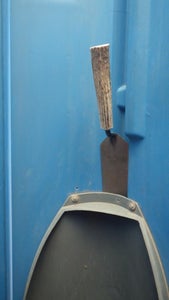

Next, you're going to find a section of antler that is long enough and straight enough to cover the trowel's tang. For most of mine, I found antlers out in the woods. For the last one I did, however, I used a section of elk antler that was sold as a dog chew toy in a pet supply shop.
At least one of the ends of your antler will be sawed, perpendicular to the axis of your new handle. The other end can be sawed off also. On a couple trowels, I had antler bases, with the "crown" still in place. I think these look really cool and prefer to use them when I can.
Before you cut your antler to length, lay it next to your tang so you get a good feel for how long it should be. Ideally, you'll only want about 1/2" of tang exposed before it drops down to meet the blade. You're not going to want the tang to go all the way down your antler and out the far end, so figure in an extra 1/2" of antler length.

Almost done here. In fact, you may be done! If you're tickled pink with the new handle, you might as well leave it alone, at least for now. You can always go back and get fancier. There are a million options for spicing up the butt end of your trowel. If you look at the photograph of two trowels, you'll see that the one on the right has an antler handle that I made. I work in the Mimbres region of southwest New Mexico. I went on Ebay and ordered a miniature Mimbres bowl cast of pewter. It was actually a necklace pendant, but I filed the little loop off. With a Dremel, I made the antler crown concave enough to accept the tiny bowl. Then I just epoxied it in place. You can also use coins, polished rocks, "challenge coins", "geocache coins", or whatever. I'm considering a steel spike for my next one that could be used to break free caliche or fend off zombies.
