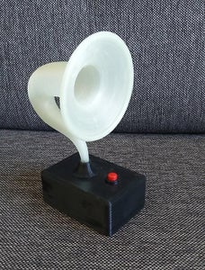

And do this is where the following device comes into play. In short it is an alarm that connects to your home wireless network. If you are having trouble reaching someone who you know is at home, you can trigger the alarm using your mobile phone. On hearing the arm the guilty party can silence it by pushing the red button and then go to their phone to call you back; resulting in all being well once again.

I printed the horn in a glow-in-the-dark filament which give a good effect at night.
From the FreeCAD model you will see that I original had mounts for the PCB but the Buzzer was too thick resulting in their not being enough space to mount the board on these. I therefore reprinted without the mounts and hot-glued the PCB to the base.
Once again I see how important design it. If I were going to do this again I would
  • Include a fence to mount the buzzer in
  • Change the opening at the bottom so that the board can be mounted properly without hitting the buzzer.

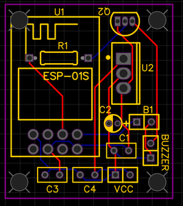

The schematics and code are all self explanatory.
I used a LM3940 to regulate the power, bringing it down to the required 3.3V and then the GPIO0 pin of the ESP-01 to drive the buzzer and the RX pin (in a pulled up state) for the button.
I am very much self taught so the configuration and component values might not be the best but the project works as required so I am happy.

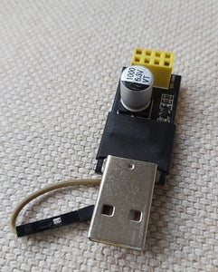

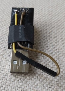

To programme the ESP-01, I used a ESP01 Programmer Adapter UART CH340 USB to ESP8266. Note to enable programming, you will need to short out two of the pins (as shown in the photos)

The horn was attached with epoxy glue and the buzzer and USB-C power socket with hot glue.
From the video you will see that it all works well i.e. the buzzer can be triggered (or silenced) from the web GUI and the button can be used to silence it. Because of the delays, in the code (between sounding and silencing the alarm) the button needs to be pressed for up to two seconds before the buzzer is silenced.
