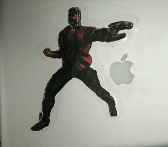

When we got our Silhouette Portrait, we immediately knew we could use it to create vinyl decals. But most of the decals we had seen were in solid coloured vinyl, and it got us to thinking. Surely we could use the Silhouette to create any decal we wanted? So we had a little experiment, and of course it could! You can create a decal from anything that you can print, and as long as it is smaller than the cutting area of the Silhouette, you can always protect it, and make it look neat and professional. Best of all, the decals are easily removable with no residue. I chose to make a Star-Lord laptop decal for my friend as that is his favourite Marvel character.

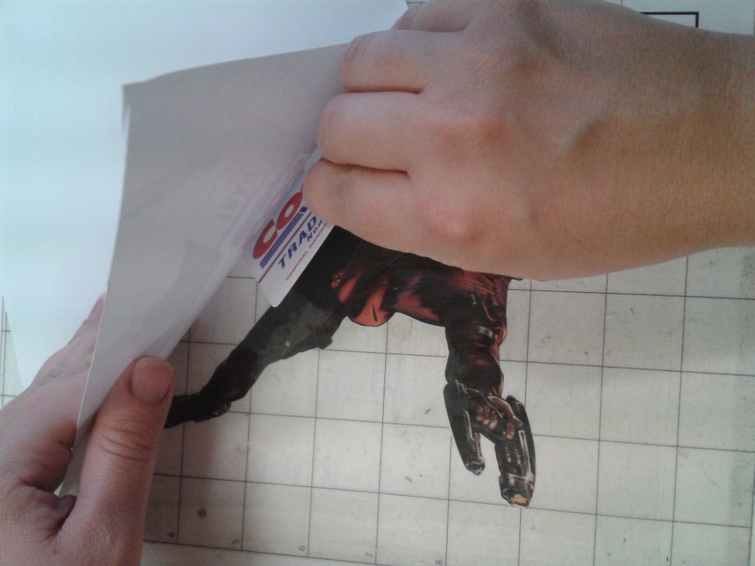

The next thing we need to do is weed out the excess paper from around our decal. We don't want to dislodge the registration marks though, as we will need them in the next step! You will therefore need to carefully cut or tear the very edges by the registration marks. You can then remove the excess paper from around your decal.

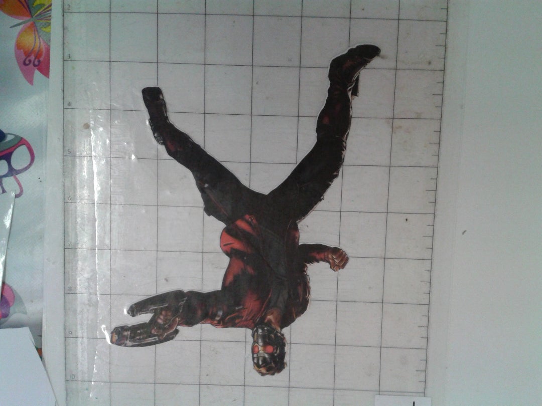

Next, top your image with clear vinyl, without disturbing or removing the registration marks from the cutting mat. Start in one corner and slowly press the vinyl to the cutting mat and decal, carefully peeling the backing away as you go. It can be helpful to use a ruler, credit card or similar to push bubbles out as you go.

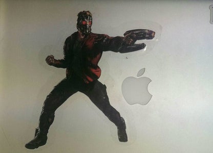

Next, we need to create an offset cut for the vinyl. First, cut the image from the Silhouette file - once it has printed, it has served its purpose, and it is easier to work without it. Then open the offset menu. Highlight the cutting outline of your decal, select offset on the right, and use the slider to increase or decrease the offset value as you choose. Thicker offset mean that the decal will adhere more securely, but too wide an offset can look unsightly. I chose a 1cm offset for my laptop decal. Once you have done this, delete the original cut line, reinsert the cutting mat into the Silhouette and cut the offset on the vinyl.
Step 6: Stick It!
Once you have done this, your decal is ready! Carefully remove from the cutting mat and stick wherever you like! I hope you have enjoyed this Instructable and that you have lots of fun creating your own decals.
