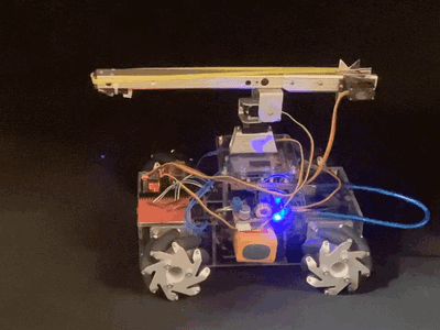

Introduction: App Control a Rubber Band Gun on a Mecanum Car
The goal of this project is to design a system for remotely operating a rubber band gun mounted on a car equipped with mecanum wheels. This functionality is enabled through an Android application, which establishes a Bluetooth connection. As the car moves, the user can launch a rubber band by tapping a "fire" button on his smartphone.

Step 4: Rubber Band Gun
As illustrated above, I constructed my rubber band gun using handle tubes salvaged from a broken piece of luggage. The mechanical movement is achieved using three small servos. Two of these servos are employed for controlling pan and tilt actions, while the third servo is responsible for rotating an actogram, an eight-angled star polygon. Since this servo has a maximum rotation angle of 180 degrees, it can fire up to four rubber bands. To control these servos, I'm using the PCA 9865 servo driver.
I have included a small program called “ServoAngle.ino” that allows you to adjust servo angles using the Serial monitor. To utilize this program, you'll need to install the Adafruit PWM Servo Driver library, which offers a convenient way to control multiple servo motors through the I2C communication protocol. It's important to note that this library utilizes pulse length rather than angles for servo control. Therefore, you may need to fine-tune and experiment with the pulse length to ensure each rubber band can be loaded and fired accurately. Additionally, the pan-tilt function has been tested and confirmed to be correct.
Step 5: Building the Vehicle
The chassis of my vehicle is constructed using 1/8” plexiglass. I've positioned the stepper motors and battery below the deck, while all the electronic components are placed above the deck. For power, I've opted for a 3S 1,500 mAh lipo battery, which, when fully charged, has a voltage of 12.6 volts. It's worth noting that the recommended voltage range for powering the Arduino Mega through its barrel jack falls between 7 and 12 volts. Using a voltage outside of this range could potentially damage the board.
To address this voltage disparity, I've employed a buck converter to reduce the voltage to 5V for the servo application. I've also chosen to split the output: one to power the PCA9685 servo driver and the other to power the Arduino Mega through its USB connection. You can refer to the wiring diagram provided above for a visual representation of this setup.
