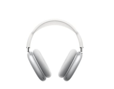

Introduction: Apple Airpods Max Ultimate Repair GUIDE!
Apple Airpods Max’s fail in the same way after between a year and 3 it seems. They fail because the connections between the cups on each side fail. They fail in two ways, the sockets the headband plugs into get moisture inside them and they corrode and also the tiny ribbon inside that facilitates the sideways movement of the cups degrades and fails. Symptoms from this failure are varied due to the fact any one of these wires fail or become intermittent but typically include unexpected noises, drop outs of connection and not being able to connect to your iDevice. The permanent robust solution is to hard-wire the cups directly to each other with tiny but highly flexible silicon wires, eliminating the troublesome connections that fail completely.
To avoid the ribbons inside becoming damaged (if yours still function) try not to turn the cups (ie so that they lay flat on the table) or use the case that comes with the headphones. Every time you twist the cups, the ribbons inside flex and they eventually it degrade. I recommend that if yours still function fine (and to avoid having to do this repair that I am proposing here) using a stand that will charge the headphones without the cups having to be twisted to lay flat. There is one out there called the Max Stand (https://www.themaxstand.com/), it works great. It prevents damage to these ribbons and also to the charging socket. Also, to prevent damage from condensation that forms on the cold metal headband running into the tiny delicate copper connections where they enter the cups, put some dielectric grease in the cups before issues occur.
However if yours have broken then follow this guide to repair them!
