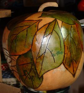

6. Now for the really fun part, adding color. For this gourd, I used Gourd master ink dyes from Welburn Gourd Farm. I used micro brushes to apply color to small areas and the ink stamping pads, which are about an inch in diameter, for larger areas. Colors used were Cherry Red for apple color; Barn Red and Brown for lips; Green, Olive Green , Pine Needle Green, Mango and Cherry Red for leaves; Brown and Dark Brown for caterpillar eyebrows.
These ink dyes are great for gourds; they allow the underlying gourd surface to show through very subtly, but are really rich in color and blend well. If you catch a mistake right away, you can use baby wipes to wipe off unwanted color. A bit of paper towel blends the colors nicely. These inks don't show overlap the way leather dyes do.
I use an old gourd piece for a sampler for the ink dyes. I labeled each color that I stamped onto the gourd so I can use it as a reference. It really comes in handy.
I allowed the gourd to dry, then dabbed it with Gourd Master Varnish. I allowed individual coats to dry in between. I probably did about three coats. I'm including a few extra pictures which show close-ups of the leaves and face. Enjoy. Please e-mail me with any questions. Happy Crafting!
