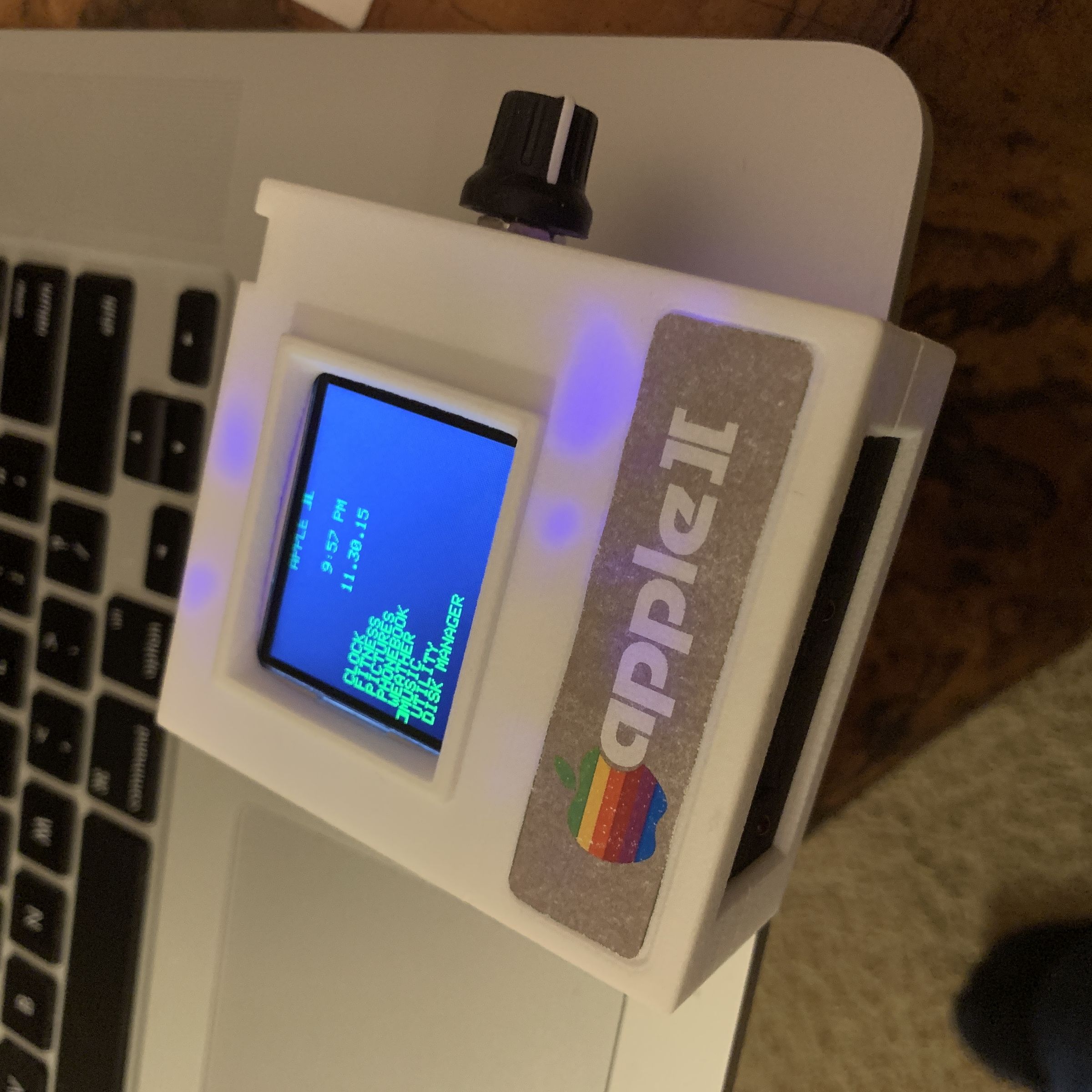

When I set out to design the Apple II watch, I originally planned to create a faithful tiny replica of the classic machine in a wrist-sized form factor. While researching the design I began to ask if I really just wanted to make a miniature, or something altogether new? I settled on the latter. The design would be a working* device, heavily inspired by the form factor of the full size computer, but it would also be an imaginative exploration of a wearable tech world that began long before we had the technology to do so in a meaningful way. Calculator watches are already, by definition, a wrist-worn computer, and are pretty neat, but there's just something so appealing about the idea a tiny wrist-worn CRT. I also wanted to push my new 3D modeling skills as well, so building a reasonable complicated enclosure was a fun challenge.
Does it run BASIC?
Although the MCU I'm using runs at a blistering (by early 1980's standards) 72 MHz , the watch functions are mostly parody of the modern Apple Watch. My version does keep and display the real time and date, the rest of the UI is mostly for fun. I considered spending the time to add a BASIC interpreter (either Woz's Integer Basic or perhaps Tiny Basic), but the return on my time would be diminishing. I spent about 3 weeks casually working on the case design and basic circuitry and another week on the graphics and software.

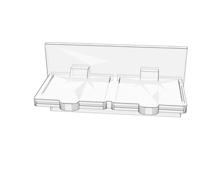

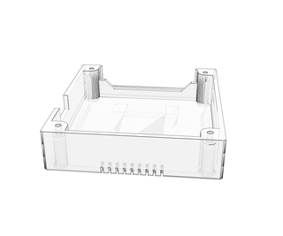

Step 5: 3D Print an Enclosure
I designed the watch using Autodesk Fusion 360 and printed the entire watch on an Objet Connex printer, allowing for the fine details and certain things like the "CRT glass." I've attached the .stl files for anyone who wants to print their own. If you don't have access to a 3D printer, you can use Shapeways, Ponoko, or 3D Hubs (which is built into intstructables) all very awesome services who can print nearly anything.

Step 7: Stickers!
For an added touch I wanted to add a little prop to make the watch seem even more scaled down (the watch is roughly 1:6 to an Apple ]['s monitor). With this scale in mind, I decided to create a 7/8" floppy disk that could slide into the front face of the watch. I found a high resolution photo of a 5.25" floppy and created a vector file for printing. I used a Roland vinyl cutter/printer to turn the floppy artwork into stickers, which I then adhered to a thin piece of laser-cut card-stock in order to give them some rigidity. I went through a similar design process for the Apple logos on the inductive charger and main case. I've attached the artwork for the floppy disks and logos as .PDFs above.
