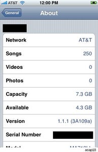

Check your firmware versions via Settings/General/About (below)
or see the Update screen in iTunes when you sync. It MUST be 1.1.1!
You'll need to DOWNGRADE later versions TO THIS version 1.1.1 from ALL later versions.
