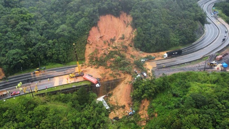

Landslide is a critical natural geological hazard that causes severe damage to property, infrastructure, and humans. Historical landslides occurred around the world caused disasters, deaths of number of peoples and destroyed homes, structures and loss of plant life.
What is a landslide and what causes one?
Landslide which is also called as landslip is defined as the movement of mass of rock, debris, or, earth, down a slope. Landslides are a type of "mass wasting," which denotes any down-slope movement of soil and rock under the direct influence of gravity.
Here, Gravity is the primary driving force for a landslide to occur, but there are other factors affecting slope stability, that produce specific conditions that make a slope prone to failure. In many cases, the landslide is triggered by a specific event, (such as, a heavy rainfall, an earthquake, a slope cut to build a road, and many others), although this is not always identifiable.
Hazards can be mitigated mainly through precautionary means, for instance, by restricting or even removing populations from areas with a history of landslides, by restricting certain types of land use, where slope stability is in question, and by installing early warning systems based on the monitoring of ground conditions, such as, strain in rocks and soils, slope displacement, and groundwater levels.

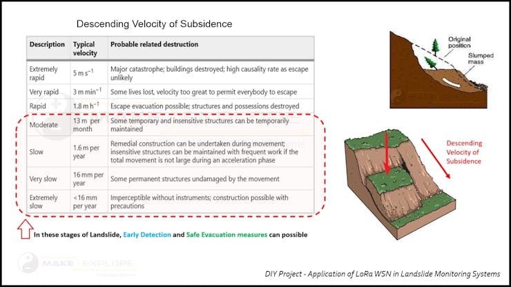

  • By monitoring descending velocity of mass in Landslide or subsidence, over period of time, and by using statistical analytical Techniques of likelihood findings, we can predict or early detect the landslide events.
  • Here in following table, there are different types of Landslide events are categorized according to the descending velocity of mass or debris.
  • So as per these stats, in point of view of safe evacuation of peoples living in Landslide prone areas, these four landslide events can be easily early detected and loss of lives can be avoided. Extremely slow, Very slow, slow, and, moderate movements Landslides can be early detected, before they enter into rapid and extremely rapid modes.

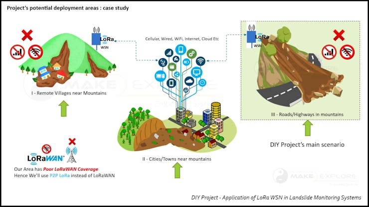

Lets see the feasible scenarios of project’s application. We will consider three main cases.
  • First, Landslides occurring at Remote villages near mountains,
  • Cities or towns near mountains, and
  • Roads or Highways passing through hilly regions.
  • If we consider this city's case, then use of LoRa WSN, or LoRaWAN will be unnecessary here, because, other more faster and reliable Wired or wireless communication services like, Ethernet, GSM 5G, Wi-Fi, will be available near this town.
  • But for other two scenarios, There may be lack or unavailability of Cellular or Wi-Fi Networks. In such areas, to monitor data of the Landslide events, LoRa wireless sensor networks, can play very important role. If these sites comes in range of 5 to 10 Kilometers, from well connected city, then P2P LoRa or LoRaWAN can be used. Moreover P2P, means, Point to point/ (Peer-to-Peer) LoRa network, will be more affordable than that of LoRaWAN.
  • **Since our area has very poor connectivity of LoRaWAN Gateways, we will consider third scenario for implementation of our project as more sophisticated than other two. Lets see this third scenario in detail.
  • Most of the time, roads passing through mountains lacks wireless connectivity. Landslides occurring in such areas may cause accidents and closure of the roads. If any Landslide monitoring system deployed in such areas, it is very difficult to send its data to concerned authorities if cellular networks have no coverage. That’s why we are proposing solution with LoRa WSN. Since LoRa can easily cover distance up to 5-10 Kilometers.
  • So, for the implementation of this Project's concept we'll need LoRa Transceiver modules or development boards with good LoRa transmission range.

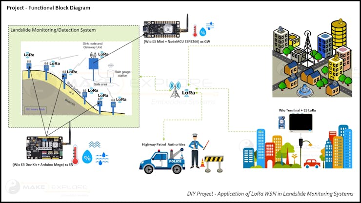

  • Suppose there is Landslide monitoring system, which incorporated different LoRa wireless sensor nodes.
  • Suppose this system has been deployed at Landslide prone area in hilly road. Where WiFi and cellular networks are unavailable. This system is connected to nearby cities and Highway Patrol Authorities, via LoRa.

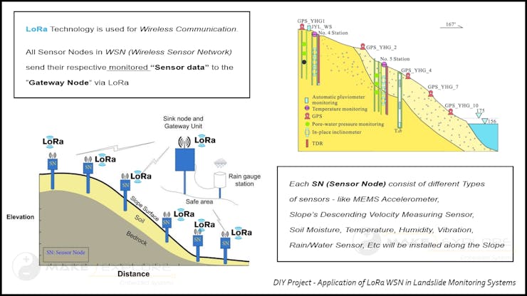

  • For That, We will use Wio-E5 Dev Kit as Sensor Node. In actual Landslide monitoring system there will be multiple sensor nodes for covering whole Downslope area, but for the sake of design simplicity, we will simulate only 7 sensor nodes using Wio-E5 Dev kit and Arduino Mega2560.
  • Which includes two soil moisture sensors, One MEMS Accelerometer, "Tipping bucket Rain Gauge Sensor", Vibration Sensor, Temperature and Humidity Sensor.
  • As shown in above figure, all these LoRa sensor nodes will be then connected to Gateway Node. At Gateway node, we will use another LoRa development board by Seeed studio, that is Wio-E5 Mini, interfaced with, NodeMCU ESP8266.
  • As figure shows, the Gateway node will be at some distance from other wireless sensor nodes at Landslide prone area. This gateway node also include some sensor, like, another "tipping bucket Rain Gauge Sensor" and Temperature Humidity sensor.
  • This is just for conveying 'rain density difference' in landslide prone areas and other surrounding areas. Gateway device will receive WSN data from different sensor nodes from landslide prone area. Then, it will add data from its own area, then finally combining both place's data together in one frame it will send it to the end nodes.
  • We will use Wio Terminal interfaced with Grove Wio-E5 module as an End Device. It will receive data relayed by Gateway device. Now once we receive all the sensor data from the Landslide prone places, at well connected cities, we can do anything with it. Like, cloud sharing, processing, analysis, prediction and Early detection.
  • Therefore, by monitoring descending velocity of mass in Landslides or subsidence over period of time, and by using statistical analytical Techniques of likelihood findings, we can predict, or, early detect the landslide events. And Eventually, Concerned Authorities can take Evacuation and safety measures as per the findings.

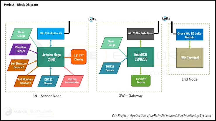

Step 3: Functional Block Diagram for Each Node
Ok so following figure shows the functional block diagram for each node, including its components.
Below in schematics section, We have shared all the circuit schematics of the Project, for Sender Node, Gateway Node and for End node. We will also share the other circuit diagrams for each individual interfacing of components. We highly recommend you, to go stepwise. Test all devices with separate interfacings and then combine them all to make final project. We will share all circuit schematics on Project's GitHub page.

As shown in above block diagram we are going to use second method. We are going to use Arduino Mega2560, NodeMCU ESP8266 and Wio Terminal with Wio-E5 Dev boards and Grove Module in our project.

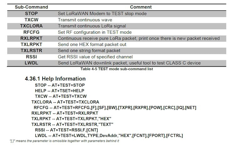

  • Wio-E5 series has a built-in AT command firmware, which supports LoRaWAN Class A/B/C protocol and a wide frequency plan: EU868/US915/AU915/AS923/KR920/IN865. With this AT command firmware, developers can easily and quickly build their prototype or application. You can download the 'AT Command Specification Guide' from Wio-E5 Wiki page.
  • The main AT command Mode, which we have used in this project is, the TEST command, as the documentation says,
The TEST command is not like other command, it is a serious command, includes several sub-commands, refer to table below. With test mode, user could do RF performance test quickly without any knowledge of LoRa chip. Commands which are related to RF configuration is disabled in test mode.
TEST MODE command - and subcommands
Before starting communication between two LoRa nodes, we need to run specific  sequence of commands  to configure Wio-E5 Dev boards in LoRa Transmitter and LoRa Receiver Modes. Please go through following two sequences,
TEST Mode AT Command Sequence for Wio-E5 LoRa Boards -

You'll find out that these are subcommands which are given above in TEST mode.

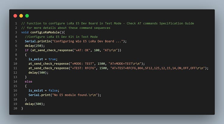

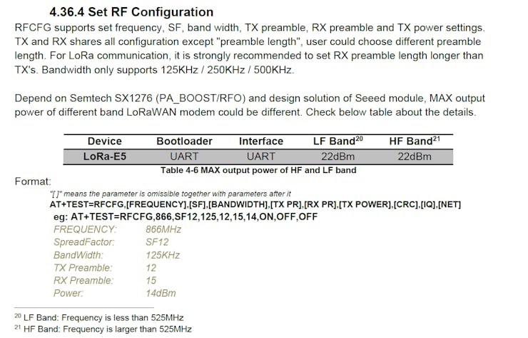

  • Command RFCFG - we have to use this command to set the RF configuration. Here, please note that, you have to set the Lora frequency or band, as per your country and region. As we are testing it in India, we have set it as Standard, IN865 band. likewise, you have to set it as per your countries LoRa Standard allocated by LoRa Alliance.
You can see how we used RFCFG command and TEST command in the following code snippet (From our Projects Source Code), which is the function to configure Wio-E5 Lora Boards in Test mode.
Code Snippet from DIY Project's Source Code - revealing how the AT commands used to configure Wio-E5 Boards

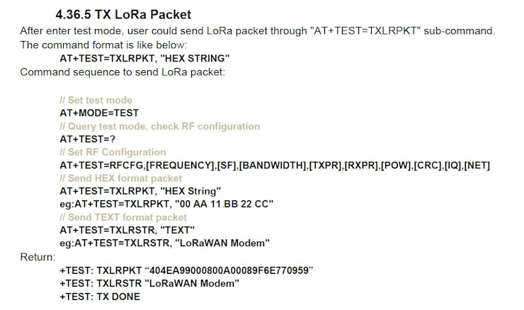

  • Then for sending LoRa packets from sender to receiver - we have to use another commands from above give code sequences, which are TXLRPKT and TXLRSTR.

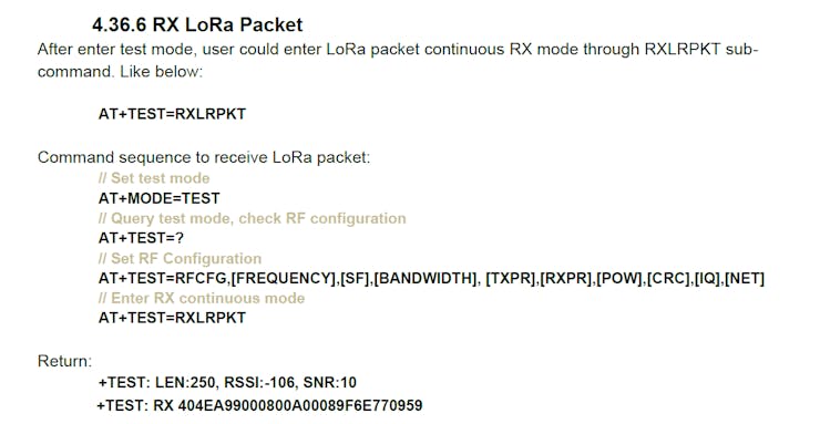

  • To receive the LoRa data packets sent by sender at Receiver Node we have to be in reception mode, following command sequence configures Wio-E5 in LoRa receiver Mode
Please note that the Wio-E5 LoRa Boards can receive the messages only in HEX format whereas it can transmit in both HEX as well as STRING format.
