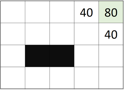

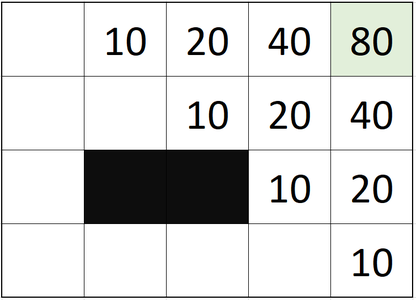

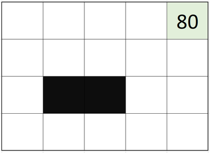

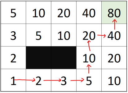

Let's do a simple example of a value map. Let's say we are in a 2D world, and we can move horizontally or vertically one tile at each time step (like Pokemon, or simple 2D video games), and we always go the direction we want. This is called a deterministic system - there's no randomness. We want to know the fastest way to the top right corner from any given point on the map.
So, what do we do? We give a reward value to that top right corner - 80 points, then set a discount factor of 0.5. This means that each tile will have a value of 1/2 the best tile you can reach from there. To fill out the map, you just go over each tile, find the best tile you can reach, then multiply that tile's value by 0.5 and stick it in the current tile. This way, the reward in the top right "flows" down the map. To take the best action, just choose the action that will take you to the best tile you can get to - viola! You know the best way to get to the top right!

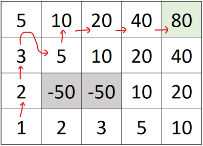

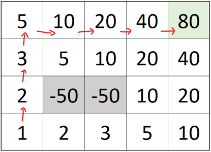

Now let's mix it up. Let's say we have a stochastic system, where if we try to go forward, sometimes we accidently move left or right. In this case, we have a penalty for colliding with those barriers in the middle of the field. We fill out the value map similarly, but the value of a tile is now the value gained on average from the best action to take. We also add a penalty to hitting a barrier, to make it more fun!
Now, when we are choosing the best action to take, we need to consider the average reward of each action. We look at all the tiles a certain action could put us on, then multiply the value of each of those tiles by the probability of ending up there, then add those numbers:
reward_of_action = sum(reward_of_each_possible_outcome * probability_of_that_outcome)
This way, we make sure to follow a path that minimizes the risk of crashing into barriers.

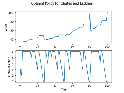

Step 9: Plot the Results
Nothing fancy here, just show us what we came to see!
# plot everything, excluding the slush tiles (101 - 106)
fig, axs = plt.subplots(2)
axs[0].plot(valueMap[:101])
axs[0].set_ylabel('Value')
axs[1].set_ylabel('Optimal Action')
axs[1].set_xlabel('Tile')
axs[1].plot(policy[:101] + 1)   # add 1 because action '0' moves you forward 1 tile
plt.show()
From the plots, we see a value map on the top, and our optimal policy on the bottom. The value map shows the value of each tile, where the goal is to head uphill as quickly as possible. It's interesting to see where the value map dips down. Each place the value map dips down is where we've missed a ladder, or come on a section with a bunch of chutes.
The optimal policy is our key to winning. Find the tile you're currently on, take the suggested action, and on average you'll win more than any other strategy!
