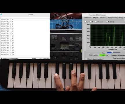

FFT or Fast Fourier transform is one of the most important tools in signal processing. This can be used to detect frequencies with good speed. However, it is a computationally-intensive process and takes a good amount of processing power as well as memory especially on Arduino. This makes it difficult to use for real-time applications where multiple FFT results required every second.
In this instructable, the fastest program to perform FFT on Arduino is presented. I am naming it ApproxFFT as there are so many approximations taken at multiple stages. However, with very little compromise inaccuracy, I was able to achieve around 3 times speed.

If you refer to the attached image, it is very clear that QuickFFT has some significant advantages over conventional approaches (speed calculated with inbuilt sine/cosine functions for EasyFFT). It is almost 4 times faster but lacks accuracy. As can be seen in the second image, the amplitude is way off. The main reason behind this the fact that we have used the square wave (Approximate sine wave!!!) that consists of multiple frequencies (harmonics). there are multiple waves present in the result that makes it difficult for various applications.
Here we have assumed the sine/cosine wave as a square wave. If we take some better approximation for these waves we can reach close to the exact output. In this code better approximations were considered for these waves. we also have some provisions to control the accuracy of these waves. By tweaking this setting we can also play with various accuracy/speed relations.

All the test shown on the above image is done on Arduino mega with an accuracy level of 5. below are some of the significant observation on the test:
- Speed is more than 3 times faster than conventional FFT,
- Memory consumption is low (almost half),
- The output is comparable with exact values (low error),
