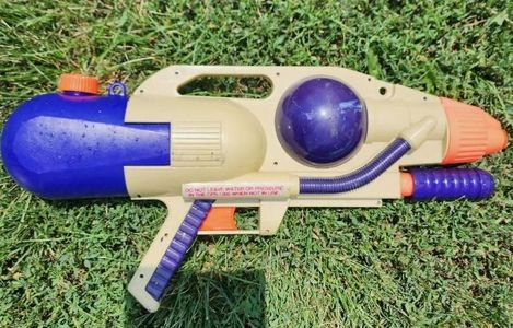

I remember as a kid my parents one summer bought me the latest and greatest in water gun technology, a Super Soaker CPS 1000. At the time, I couldn't even hold the thing when it was full and had to rest it on the ground while I pumped it and then aimed and shot it at my brother, the fence, or anything else within range. This toy lasted for many years to come, but finally fell apart after countless summers of endless water fights.
That being several decades ago, I had expected water gun technology to have continued to advance over the years, but it appears companies refusing to pay patent licensing fees has caused all water guns using this pressurized technology to go off the market (Super Soaker history).
