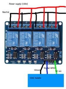

Step 2: Getting Hardware Ready
1. Plug the Temperature sensor in the extension board into an Analog Pin, which you would configure as input in software. On the board look for A0~A4 (we used A0)
2. Plug in the Servo into another analog pin (there are other servos which run with digital PWM pins, it depends on the servo you pick). We chose to plug it in A3.
3. Each channel of the 4 channel relay can be used to control any 120V high-current AC devices via the 5V GPIO outputs coming from the Intel Galileo board. We used digital pin 3 (D3) to control the light control. Look in below section for the instructions on how this is hooked up.
Step 3: Setting Up the Relay
The relay will be used to control the lights, heater, water pump and filtration unit independently. The image above shows how the wiring needs to be done. A specific digital gpio is used to control the power to each of these units.
The second picture shows how the we modified a cheap power socket to control the lighting.
