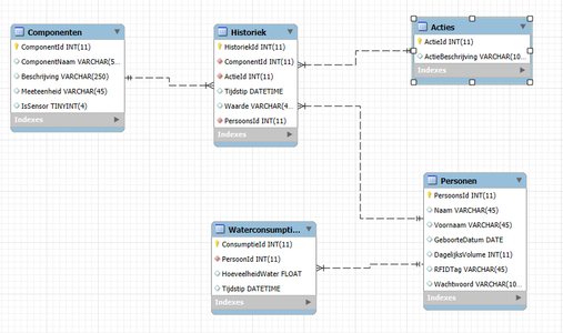

Step 1: Database
1. Components
- ComponentId: Unique ID for each hardware component (e.g., sensor, pump).
- ComponentName: Name of the component.
- Description: Short description of the component.
- MeasurementUnit: Unit in which the component measures (e.g., liters, degrees).
- IsSensor: Indicates whether the component is a sensor (1 = yes, 0 = no).
2. History
- HistoryId: Unique ID for each historical event.
- ComponentId: Refers to the involved component (relation to Components).
- ActionId: Refers to the performed action (relation to Actions).
- Timestamp: Date and time of the event.
- Value: Stored value (e.g., measured quantity).
- PersonId: Refers to the person involved (relation to Persons).
3. Actions
- ActionId: Unique ID for each possible action (e.g., "water dispensed", "sensor read").
- ActionDescription: Description of the action.
4. Persons
- PersonId: Unique ID for each user.
- LastName: Last name of the person.
- FirstName: First name of the person.
- BirthDate: Date of birth.
- RFIDTag: RFID tag for identification.
- Password: Password for login.
- DailyVolume: Daily water goal (in ml or liters).
5. Water Consumption
- ConsumptionId: Unique ID for each water consumption record.
- PersonId: Refers to the person who drank the water (relation to Persons).
- WaterAmount: Amount of water consumed (FLOAT).
- Timestamp: Date and time of consumption.
Relations between tables
- History is a central table that logs events and links to components, actions, and persons.
- Water Consumption directly links a person to a consumption moment and the amount of water.
- Components and Actions are connected to events via History.
- Persons are linked to their actions and water intake via both History and Water Consumption.

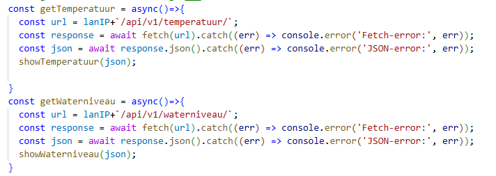

App.js:
Key features:
- Live Data Visualization:
- Shows current temperature, water level, bottle weight, RFID tag, and user’s water goal.
- Visualizes progress towards daily water goals and displays consumption history and statistics with dynamic charts (using ApexCharts).
- Real-Time Updates:
- Listens to Socket.IO events from the backend for immediate updates when water is dispensed, RFID is scanned, or sensor values change.
- Updates the UI instantly when the state of the hardware changes (e.g., bottle detected, water goal changed).
- User Interaction:
- Allows users to adjust their daily water goal and submit it.
- Handles user login, registration, and logout.
- Provides feedback and disables/enables controls based on system status (e.g., when the bottle is missing or the device is dispensing).
- System Controls:
- Enables safe power-off of the Raspberry Pi via a protected button.
- Manages button states and feedback colors for clear user guidance.
- Data Fetching:
- Fetches sensor data, user information, and consumption records from the backend API.
- Updates charts and statistics based on the latest data.
