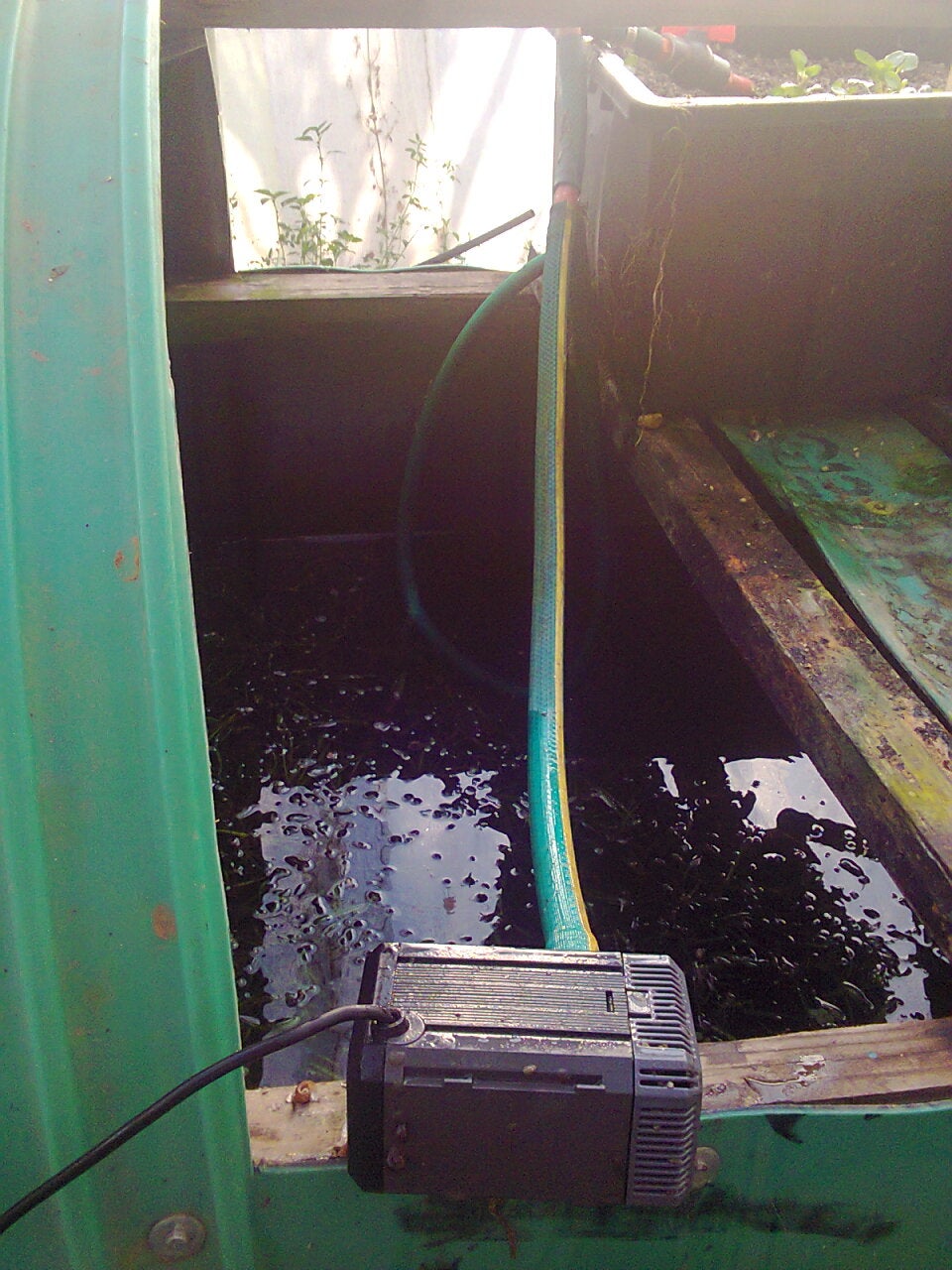

I was given a 2000L water tank that had been burnt in a bush fire on one side.
I looked and saw that if I used the unburnt side as the water retaining section it could work as a fish tank, but I had to lay it on it's side.
I cut down the central section that had been burnt and reinforced it with 2 x 4's.
Roofing screws and washers were used to attach the plastic to the 2 x 4's along the sides, top and accross the central section which was the covered with plastic offcuts from the cut away section.
I was lucky that the outlet was on the "bottom" of the tank and could thus drain it for water changes.
I used this tank for almost 2 years to breed guppies and tilapia in.
Step 2: Converting the Fish Tank to an Aquaponic System
I used 2 more 2 x 4's to reinforce the section where the (at that stage) the gravel bed filter would go.
Using a 2000L p/h submersible pump I pumped water through the gravel bed which acted as a filter for the tank.
As the algae began to grow and help filter the water (sorry no photo's) I came accross the Instructables Website and saw that instead of just a filter, I coud get edible plants to grow from fish S@#T (Oops, I mean fish waste).

The 60L container was filled with pea gravel, (cheapest substrate I could find).
A piece of 110mm PVC pipe, with slots cut into it, was used as the gravel guard for the bell siphon
Siphon off and on, I had a short cycle (9 min) but as watercress was to be the experimental plant this did not matter.
The flow from the pump was split to allow a slower flow into the growing bed and the greater flow back into the tank for airation.
