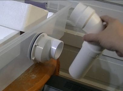

First we took an existing aquarium and placed a table and small storage tub beside it.
We used a bathtub/sink drain and found a hole saw to match and made a hole in the tub.
Step 2:
Next we placed the sink drain into the tub with rubber washer on the outside.
Step 3:
We cut two short pieces of PVC. One about 2 inches and the 2nd long enough to reach inside of the fish tank.
We also place the hose coming off the pump inside of our PVC so there would be no leaks.
