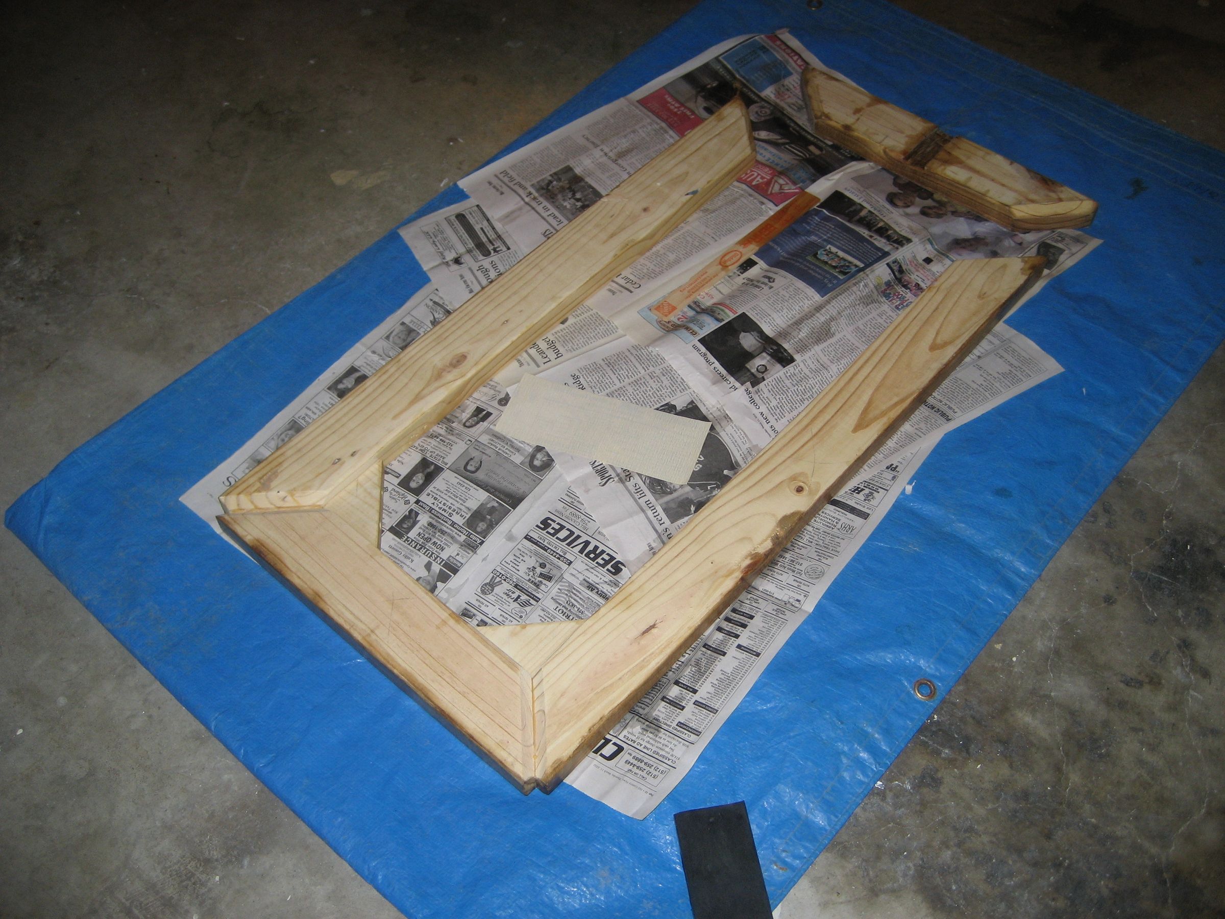

Thank you for the great  idea!  I combined yours and another instructables  fish tank coffee table.  I hope you like my 40 gallon breeder coffee table.  I don't have any fish yet because I am going to move soon but will after.  Even without fish this coffee table looks like a piece of art and draws a lot of attention when people come over.
The aquarium lies on a frame base which avoids both having to support the massive weight and scaring the fish setting things on the table.  I removed the corners where the boards meet on the base to be able to run power under the tank, then back and out up the legs. Also one side is removable so I can get to the electronics later.  The coffee table part is pretty much just a shell over the aquarium/base.  The lights on the base under the glass substrate really makes this thing.  Thank you!
