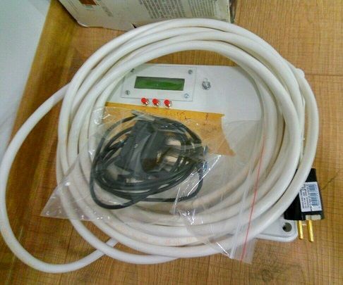

The idea behind this device is to automate my aquarium light. By automation I mean not only switching light on/off but simulating a sun raise/sunset.
The project is build around arduino nano, set of white led( cold and warm), set of RGB leds and a DS3231 real time clock.
The control is possible thanks to rotary encoder with a push button on its axis and a I2C HD44780 16X2 LCD.
This project can be build for every applications that needs to simulate sunrise/sunset daylight, colors etc.
For example you can use it in you terrarium, vivarium or just in the corner of a dark room above the plants.

Step 3: Build, Testing and Future Updates
I build everything on a bread board(lazy lazy lazy...), cause it was just an temporary project...but actually like everything temporary, it's running for almost an year till now. The idea for this aquarium was to have something green self sustained in the bathroom. I was thinking only for plants, but then I took few shrimps.
One think that is not included here, but I planned to do it, is to simulate a lightning storm. The software is almost ready but I still can't find a time to implement it...it is working now so why to touch it(lazy again :) ). I was thinking to use AS3935 for that purpose, but we will see :)...
Second think is a library to set up your sunrise/sunset based on geographical coordinates so the sunrise/set to mimic the real light outside.
Currently only 1/3 of the arduino nano memory is used, so there is a possibility for a wide variety of extras.
It is easy to add a Humidity/Temperature sensor so if you have a flowers (vivariums or something) to monitor the humidity and switch on/off a humidifier or something similar.
What else...o yep...moonlight simulation, but may be in the future with another menu - UPDATE - Jandy171 already added this future. Find details here .
I am gathering ideas for DIY automatic fish feeder :), so finally I can be 100% lazy :).
