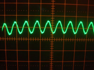

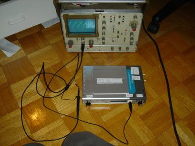

The photo demonstrates a 1Mhz sine wave generated by the device.

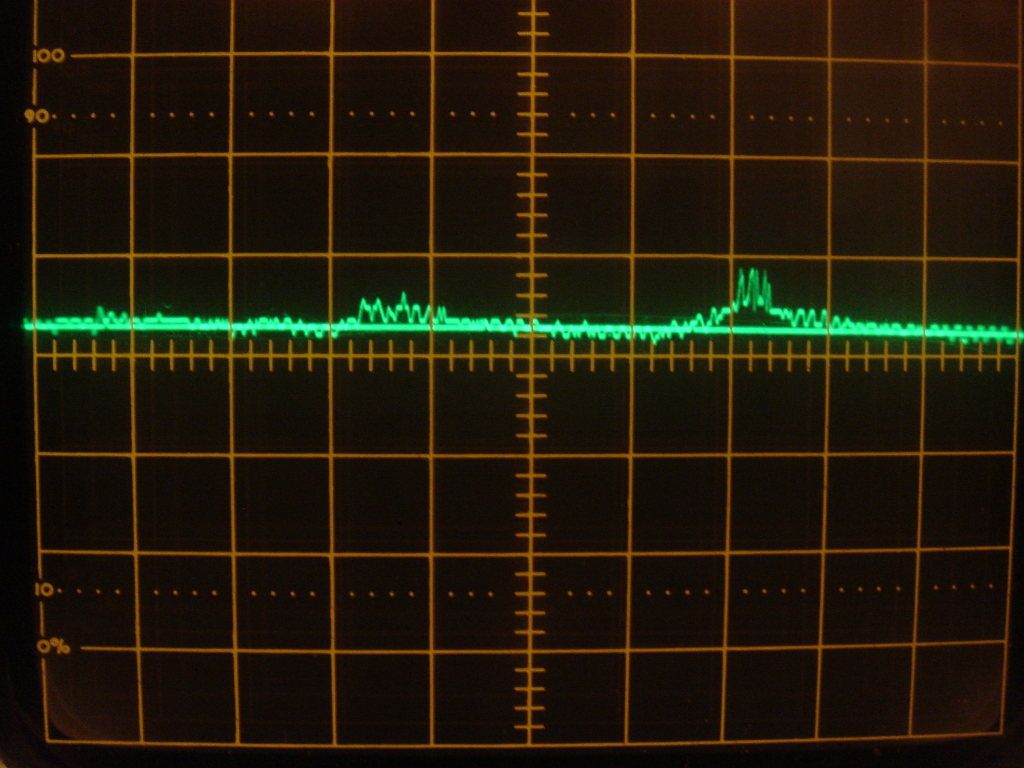

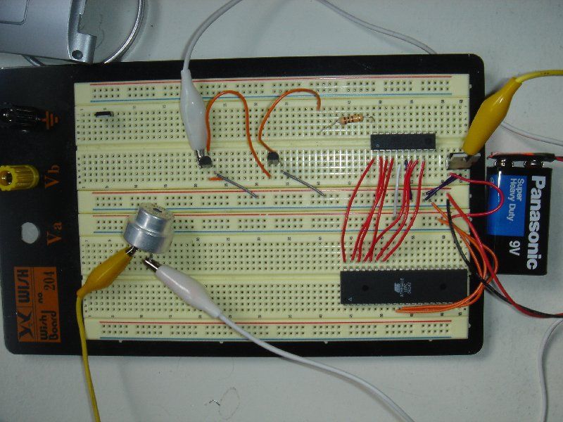

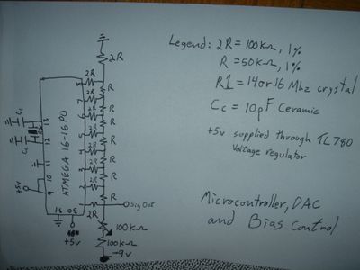

Step 1: First Circuit.
This circuit contains the microcontroller and the digital to analog converter (called an R/2R network) which generates the waveform. The waveform generated is between 0 and +0.2v, the 100kohm resistor and potentiometer act as a bias to make it between -0.1v and +0.1v.
VERY IMPORTANT: Unless you want to include switches that change the waveform type/frequency... I didn't because it involves a performance tradeoff... you will be reprogramming this microcontroller frequently. Either be fancy and include ISP, or do what I did: solder an IC socket to the circuit board, and also lodge the microcontroller into another IC socket... the electrical contact between the two IC sockets is just fine, and an IC removal tool lets you pull it out with minimum force.
Alternatively, spend an extra few dollars and get a ZIF socket. If I were to redo this project, this is what I would do.
When this stage is complete, you have a functioning waveform generator... which you should proceed to test with your scope (test the bias!). A later step will include a link to a useful site that has assembly code compatible with this microcontroller that will generate various waveforms.

Step 3: Sine Wave, 1.790Mhz
This is a sine wave generated at 1.790Mhz. Why this frequency? I used a 14.3mhz crystal... and the sine wave is generated by producing a sequence of 8 values repeatedly (ie: sin(pi/4,pi/2,3pi/4...). Our program conceptually looks like this:

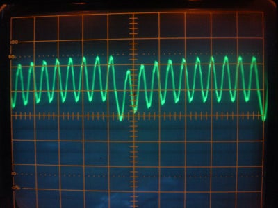

The little irregular "dip" in the waveform is caused by the rjmp statement which takes 2 clock cycles to process. To get around this, you copy/paste the sequence in the loop function many times back to back, producing many periods of the waveform for each loop. This photo is of a sequence of 10 periods per loop, the atmega16-16pu has enough memory for ten times that easily.

- weird tricks: notice how the rjmp artifact brings the voltage below the zero value of the waveform... this is because it represents the value 0 existing for 3 clock cycles, and whatever test leads you use will have a certain capacitance and inductance which resists changes in current and voltage. You could make your program produce an asymmetrical waveform by replacing r1 with a nonzero positive integer so that the voltage decays exactly to the "zero point" of the rest of the waveform over 2 clock cycles. If you can do this, then my hat is off to you.

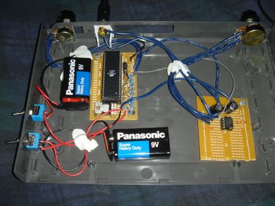

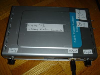

Step 4: Case
It's very useful to put this project in a case. At the very least it provides a grip when you pull out the microcontroller to program it.
Besides, I had this nice case... which was unfortunately filled with a dlink router. I provide the current example as evidence that this company's products are good for something after all.
Let it be known that dlink manufactures excellent but expensive cases, which unfortunately come with free wireless routers.
The two switches connect the batteries, the dials are for bias/gain. The output is via an RC jack. BNC or coax jacks would have also been good.
The photo with the scope shows a 2.5khz sawtooth wave. If you connect the outputs to a small speaker, you can hear it too!
N.B.: The scope photos are mainly of the waveforms I photographed before I built the amplifier. I could not see any distortion produced by the amplifier, which demonstrated surprisingly even gain for the frequency ranges produced by this device.
