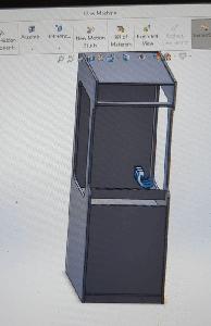

With the data acquired by inspecting and measuring the old claw machine cabinet, I went to work creating a digital model that would allow me to build parts to accommodate the existing gantry and glass, while utilizing lightweight building materials. I used SolidWorks to create top, bottom, front, shelf, rear and side panels. This was my preferred method as it enabled a great visual representation of my ideas while allowing for fast edits if/when problems arose. Once completed, the parts designed in SolidWorks were able to be exported in a 2D format to Vectric's V-carve Pro where toolpaths were created for cutting and carving on the CNC router.
All CNC cuts were made using a 1/4" dia end mill that cut fully through the 3/4" thick plywood in 4 passes, and milled a 1/4" deep pocket for the glass panels in 1 pass. After all operations were complete, the recessed sections to hold the glass panels were cleaned up using chisels and sandpaper. I wanted to be sure that there weren't any high spots that could add unwanted stress to the glass after assembly.

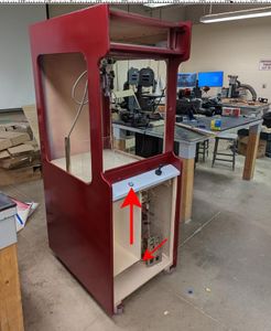

Now that all of the individual pieces were cut out, it was time to fit everything together. Much of the alignment was dependent upon the glass and metal controller panel. The width of the machine had to accommodate the front door glass door; allowing it to swing freely, but lock securely, while simultaneously providing a tight secure fit for the metal controller mounting panel. Aside from those details, I just had to be sure I secured the motherboard and carefully screwed the panels together. I used a table saw to create a chute for the plush retrieval area and an acrylic shield to hold the machine's contents from falling into the chute. The acrylic rectangle was laser cut and then bent into its final shape using a heat gun. An additional piece of acrylic was used to replace the opaque black prize door, and create a transparent one that was much more inviting.

The wiring for this project was fairly simple as most of the connections were cables that had been previously attached and were only removed to switch them into the new cabinet. There were two exceptions however. Since this machine is intended primarily for home use, I added a free credit button. This addition required a hole to be drilled in the control panel and then a simple jumper wire from the coin mechanism's trip wire. Just in case we ever wanted to disable the free credit button, I added a basic single pole switch to interrupt the trip wire. When the switch is flipped, the button will not function and credits can only be added via coins.
