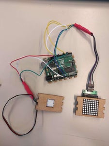

Step 1: Building the Arduino Circuit
First we need to get the electronics hooked up. For this you'll need to use the schematic made above. Be sure that the right wires are connected to the right ports of the arduino. Otherwise it won't work with the code that comes later.
As you can see in the Supplies list, there is some Heat Shrink. I reinforced the wires with the Heat Shrink so that they won't disconnect too quickly. This is not necessary to do, but it helps.

Step 4: Building Time
Because I didn't have my arduino stuff at home while I was working on the drawing, I didnt know where the holes for the arduino should be. So I drew on the back piece where those holes needed to be and created the holes.
But once you've done this, you can attack the electronics to the casing. In this case I used a hot glue gun, and gave the button a little extra support by using some scrap MDF. The button really needs this, because otherwise it would just come loose when you press the button too hard. (Make sure that you don't get glue underneith the button like I did)
After this you can put everything together, close up the back, put it in a power source, and start playing. If you want to glue everything together, you can do that. I didn't do it, because I wanted to be able to check the insides.
