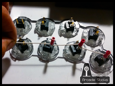

Step 1: Crimping
  1. With the wire attached to the spool, strip about 2cm (3/4 inches) of it.
  2. Fold the exposed wire in half, then insert it through the top (see picture) of the Quick Disconnect.
  3. Crimp the wire so that the metal folds in tightly onto the exposed wire. (See the pictures)
Step 2: Forming the Chain
  1. Attach the crimped daisy chain to the button that you wish to start at (with the wire still attached to the spool).
  2. Pull the wire so that it is about a little more than 1 cm (3/8 inches) past the post of the next button, then cut it.
  3. Strip 1 cm from the wire you just cut, and 1 cm from the wire attached to the spool.
  4. Twist the exposed wire together, then crimp them the same as in step 1.
  5. Repeat this for the rest of the chain.
  6. After the last button leave an excess amount of wire so that you can reach your PCB board, or ground terminal and trim it down to size.
