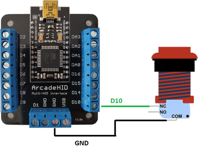

Joysticks and buttons are the most common arcade peripherals.
They consist of simple non latching switches: when the button (or the joystick direction) is pressed, the switch is closed; when released the switch is open.
Connecting switches to any ArcadeHID D# (digital) or DA# (digital/analog) pin will let the board see the state of the switch and, with the appropriate sketch uploaded, emulate a keyboard (or gamepad) keypress accordingly.
In the attached picture you can see how to wire a classic arcade button. Notice that only two of the three button pins are connected: COM to ground (GND) and NO (Normally Open) to D10.
The simple sketch "ArcadeHID - buttons.ino" at THIS link (Github) will emulate an "a" keyboard key press every time a switch/button connected to pin D10 is closed. It will also emulate a "b" keyboard key press every time a switch connected to pin D14 is closed. The "Buttons" function is written in the more readable (verbose) way I could think of and you can easily modify it to add up to 17 buttons (total).

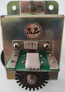

In a nutshell, both spinners, trackballs and optical wheels are rotary optical encoders. An optical encoder is an electromechanical device that uses a light source (emitter), photosensitive detectors, and an optical grating to convert rotary or linear position to an electrical signal. One emitter-detector couple determines the speed of the grating, the other the direction of movement.
We are not going to see in deep how an optical encoder work because so much has already been written and some "google-fu" will suffice if you are curious (and you should to better understand the function I will write down here).
For what concerns this Instructable, the only important thing to note is that, despite they look very very different, spinners, optical wheels and trackballs are the same thing "under the skin", the only difference being the number of optical encoders used: spinners and wheels have one optical encoder (one axis of movement), trackballs have two encoders (two axis of movement).

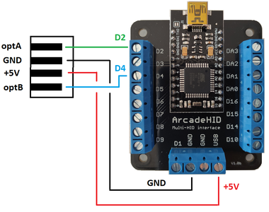

To have those peripheral working with our PC, one approach is to have their movement translated in mouse movement. This is a simple task for arduino. In the example "ArcadeHID-optical.ino" at THIS LINK (Github) the two emitter-deterctors of a spinner are connected to ArcadeHID's pins D2 and D4.
Please, notice that pins D1, D2, D3 and D7 are "special" digital pins being that they support interrupts routines. This means that every time a state change is detected (a change from LOW to HIGH in my example), the function associated with the pin is run, and every other function put on hold until the interrupt routine has ended. This is useful for those applications where timing is important. This means that you can handle up to 4 optical axes (i.e. 4 spinners, 2 trackballs or 2 spinners and a trackball...) with single interrupt routines like the one I have posted in the link above.
The function uses only one interrupt pin, but it is possible to change it to have both emitter-detector couples "interrupting" the main code when a state change is detected. I have toyed with this and, for me, there's no need for two. This is not carved in stone, anyway, and you could change it in every moment. This is the great advantage an open firmware device gives us!
Please notice that different optical devices could have different pinout with respect to the one I posted.
