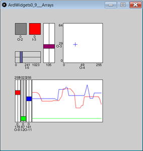

Step 5: Widget Dashboard
Here's a sketch with all of the current widgets. You can simply comment out sections of the widget setup if you don't want to use them, or just leave them in (they won't be connected to any arduino behavior if the associated pins aren't wired up, but that's OK unless you want to use the pins for something else).
The full list of current ArdWidgets is:
ArdWidgetButton - creates a Digital INPUT or OUTPUT
ArdWidgetHSlider / ArdWidgetVSlider - creates and Analog INPUT or OUTPUT
(INPUT pins correspond to Analog input A0-A6)
ArdWidgetXY - takes an array of 2 Analog INPUT or OUTPUT pins
ArdWidgetGraph - takes an array of any number of Analog INPUT and OUTPUT pins,
and a corresponding io pattern array of INPUT and OUTPUT values.
The important setup() code that creates these widgets is:
/////////////////////////////// Add Some Widgets //////////////////////////////
// Now add widgets to the ArdWidgetCollection. Basic signature is ( int x, int y, int w, int h, int anio, int apin):
// Make an INPUT Button on Pin 2 // Single line of code creates a new button Widget and adds to the collection. myWidgets.add(new ArdWidgetButton (50, 50, 40, 40, INPUT, 2));
// Define an appropriate Widget variable in order to keep the reference and then change colors, display text, etc:
// Make an OUTPUT Button on Pin 8 ArdWidgetButton button2 = new ArdWidgetButton (100, 50, 40, 40, OUTPUT, 8); button2.lowcolor = color(255,0,0); // set lowcolor to red button2.highcolor = color(0,255,0); // set highcolor to green myWidgets.add(button2);
//Make an INPUT Horizontal Slider on Pin AO ArdWidgetHSlider slider3 = new ArdWidgetHSlider (50, 150, 90, 40, INPUT, 0); slider3.highcolor = color(0,0,255); slider3.displayscale = true; // add the scale text (show lowval and highval) myWidgets.add(slider3);
//Make an INPUT Vertical Slider on Pin 9 // an INPUT widget's backround is grey by default; mouse interactions don't do anything ArdWidgetVSlider slider1 = new ArdWidgetVSlider(150, 50, 40, 140, OUTPUT, 9); slider1.lowcolor = color(255,0,0); // if lowcolor and highcolor are different, sliders will blend between them. slider1.highcolor = color(0,0,255); slider1.displayname = false; // Don't show the pin name myWidgets.add(slider1);
// Note the ArdWidgetXY takes an array of 2 pins! ArdWidgetXY xy1 = new ArdWidgetXY (220, 50, 140, 140, OUTPUT, new int [] {10,11}); // Note how we pass the array of (2) pins xy1.highcolor = color(0,0,255); xy1.displayscale = true; xy1.lowval[Y] = 0; xy1.highval[Y] = 64; // We can set the range to something other
// than the default 255 OUTPUT / 2013 INPUT
myWidgets.add(xy1);
// The ArdWidgetGraph - includes a dynamically created set of sliders and a time graph // Note we provide an array of ios and pins. The count of ios doesn't need to be the same as the pins ArdDefaultDisplayscale = true; myWidgets.add(new ArdWidgetGraph(50, 250, 310, 150, new int[] {OUTPUT, INPUT}, new int [] {3,2,5})); ArdDefaultDisplayscale = false; /////////////////////////////////// Done Adding Widgets ////////////////////////////
