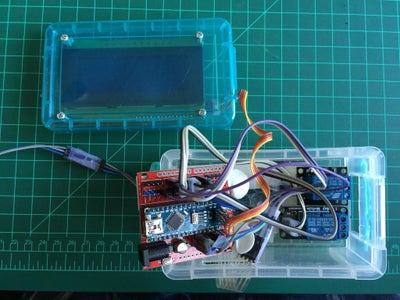

Step 2: Completing the Hardware
Starting from the Local Station developed on Part 1, the only additional HW needed is the ESP8266. The above Block diagram, shows all Arduino and main components PIN connections. The only care that you must have is related with the voltage level. The ESP8266 works with 3.3V, so the Rx Pin that should not be connected directly to Nano Tx Pin (D3). A voltage level should be used. In our case, we will build a voltage divider to be used as a voltage level converter. The above diagrams show in more detail how to connect the ESP8266. If you want to know more about the ESP8266, please see my Instructables:
Note that we are using the ESP8266 connected to Nano Pin 2 (Tx) and Pin 3 (Rx), using the library SoftSerial. If you want to "free" those digital pins, you can alternately use the Nano Serial pins 0 and 1. Only remember that you must disconnect them when uploading the code to Nano.
NOTE: If you want to connect the BUZZER, you should do it at pin D17 (same as pin A3). It is good to have a sound when you have a comm error. I used it during the test phase, leaving out at final project (the hw, but the code is prepared for that). It is up to you have it or not.
You can use the bellow code for testing and/or setup your ESP8266:

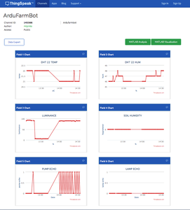

Step 4: Cloud Storage Data: the ThinkSpeak.com
All data captured by the ArduFarmBot will be uploaded to the cloud, using the free service of "ThinkSpeak.com".

The photo shows the ArduFarmBot channel at ThingSpeak.com.

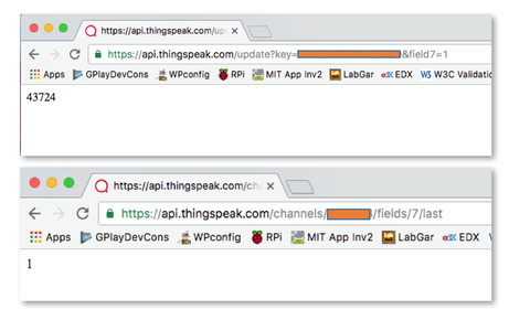

Step 5: Commanding the Actuators From the Web
At this moment we are uploading all collected data and storing them at the cloud. This is very good and useful for a remote monitoring, but what happen if based on those data we also want to turn-on the Pump or the Lamp, independent of the the local automatic program? To do that, we will also need to "Download" data from the Cloud and command the controller to act based on those commands.
We will create specifics fields on our ThinkSpeak channel to command the actuators:
- Field 7:
- Data = 1 ==> PUMP should be Turn ON
- Data = 0 ==> PUMP should be Turn OFF
- Field 8:
- Data = 1 ==> LAMP should be Turn ON
- Data = 0 ==> LAMP should be Turn OFF

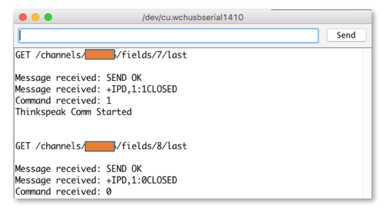

OK, but how to set up those fields directly at ThingSpeak? We can do it, for example writing a "PlugIn" directly at ThinksPeak, or we can use an external website to do it (this will be our choice). Anyway, on both cases a you should use a command like:
api.thingspeak.com/update?key=YOUR_WRITE_KEY&field7=1
With the above command, for example (and using your channel Write Key), you will write "1" at filed 7, what means that the PUMP should be turned on. You can easily test it, writing the above command-line at you browser, the correspondent field at your channel will be changed. As a return, the browser will show a white page with a single number on upper left corner, corresponding to the sequencial data entry in your channel.
50% of the work is done, now you must read this "command" (data on the field), down at the local ArduFarmBot station.
The command to do this is shown bellow. It will get the last data that was written at the specific field (that in our case will be a "command".
api.thingspeak.com/channels/CHANNEL_ID/fields/7/last
Same way as we did before, you can test the command-line, using your web browser. In this case, the browser will show you the data on that specific field. See the Photo above.
Return to "earth", let's write a function that will read this "last field":
* Read data from field7 of thingspeak.com
int readLastDataField7()
startThingSpeakCmd ();
// "GET /channels/CHANNEL_ID/fields/7/last";
cmd = msgReadLastDataField7;
cmd += "\r\n";
String messageDown = sendThingSpeakCmd();
Serial.print("Command received: ");
Serial.println(messageDown[7]);
int command = messageDown[7]-48;
return command;
The above function will return the data on field 7 ("1" or "0"). A similar function should be written for Field 8.

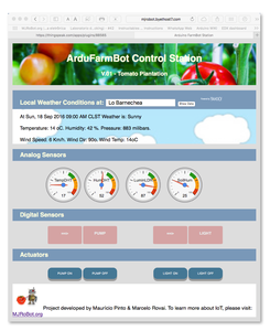

Step 6: Implementing a Dedicated WebPage
At this point our ArduFarmBot is operational and can be controlled from the web. You can monitor the data on Thinkspeak site and also send commands using a browser, but of course this "web solution" can not be considered an "elegant" one! The best way to implement a full IoT solution is to develop a complete webpage that will display all data, also having buttons to activate the actuators.
I choose the Byethost, a free webhost, very easy and simple to handle your pages. I also used the opportunity to apply on this project, what I have learned on a fantastic on-line specialization at Coursera/University of Michigan: Learn to Design and Create Websites (Build a responsive and accessible web portfolio using HTML5, CSS3, and JavaScript).
I will not enter in details how to develop such page, once this is not the center purpose of this tutorial, but I will include here the HTML, CSS and JavaScript source codes. And once someone has interest on how I got the results, we can discuss it aside using the Comments Board at end of the project.
It is important to reinforce that this page does not works directly with the ArduFarmBot Local Control Station. What it is really doing is interacting with ThinkSpeak channel as bellow:
- Reading sensor data on fields 1, 2, 3, 4
- Reading actuator status on fields 5 and 6
- Writing data on fields 7 and 8
- Reading Local weather data from Yahoo services
The item 4 above is not really crucial for the project, but always are additional data available in case you want take some remote actions independent of what is going on locally with your tomato's plantation. Other consideration is that you can for example, store those data on another ThingSpeak Channel and download it to your Arduino, showing weather data on local LCD display (I developed this on another cool project that worked fine! I leave it here as a suggestion to you).

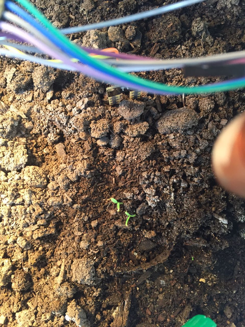

Step 9: The MJRovai Home Farm
Some sequencial photos of ArduFarmBot controling my Tomato Plantation
