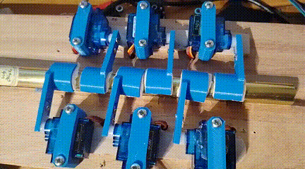

Step 3: The Servo Fingers
Print out the specified parts. Apply sealing tape to the inside of the flap. Attach the small (1/2) control arm to the servo and secure it with the small screw.
Attach the flap lever to the servo arm and secure it again with a screw. However, you have to pre-drill a little into the plastic.
You can then align the servos next to the flute. Three on the left, three on the right. Make sure that the flaps sit well over the finger holes of the flute.
Everything is fixed with the servo brackets. With my servos, I also put a strip of wood about 4 mm high underneath to align the flaps in the best possible way.
As you can see in one picture, a hole is drilled next to the cable outlet of each servo to hide the wires on the other side of the board. Looks better.
