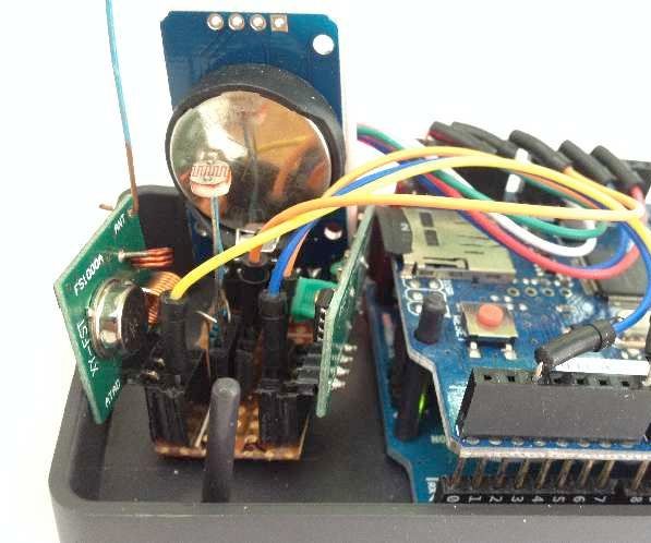

Step 1: The Circuit
Wire the diverse components as shown in the picture. Some notes:
- The audio jack shown in the picture is stereo and so it has has three legs. Two of them (left and right channels) are to be connected to the same leg of the 4N35.
- Arduino pin #8 to resistor
- Arduino pin #2 to Data pin on RX/RF module.
The logic of the solution is explained in the attached diagram picture.
