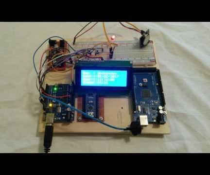

Step 5: Test
Before building the PCB, and putting it all in the box, I did several tests with the prototype chopping board.
