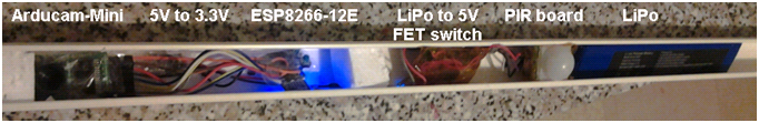

This instructable is about Arduino camera module.
Attached pdf file describes
  1. How to attach ArduCAM-Mini to Arduino-Nano and transfer pictures to a PC.
  2. How to attach ArduCAM-Mini to ESP8266 Wi-Fi module and show pictures on webserver.
  3. How to program ESP8266 to upload pictures to a webserver using http POST file method.
  4. How to run circuit from batteries and activate power when PIR detector senses motion.
