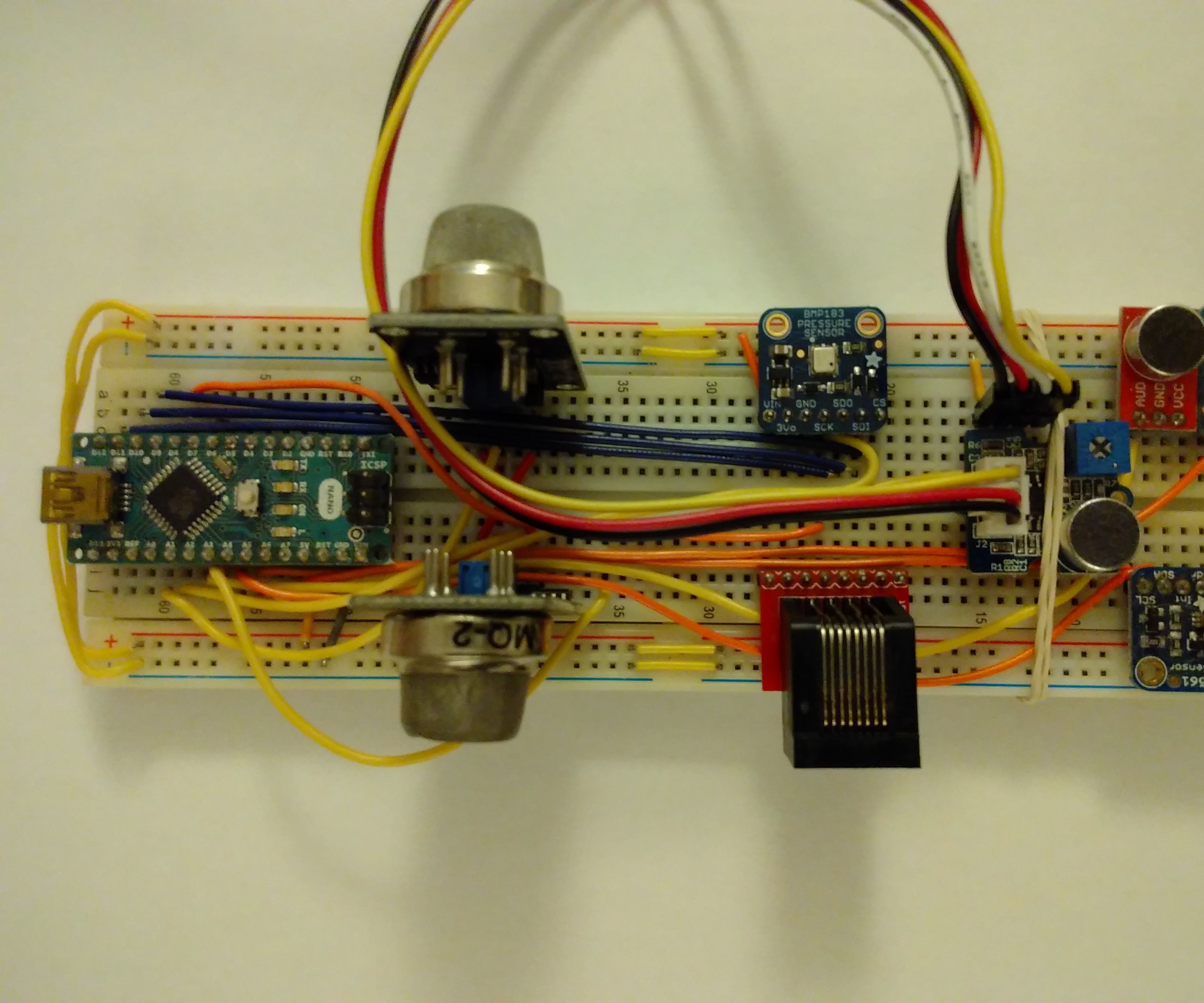

Step 1: Arduino Uno ("1-wire Bridge")
We need to connect the 1-wire bus to the Arduino Uno board and set it up in order to serve as a UART respective serial/RS-232 USB adapter or "1-wire bridge".
  1. 1-wire bus: connect the pin TXD/1 from Arduino Uno board to the 1-wire data line (blue) and GND to 1-wire GND (black)
  2. Arduino Uno board: we have at least 3 Ways to Use Arduino as USB Serial Adapter Converter and here the most simple (avoids creating and maintaining a sketch) is just to jumper RESET to GND (yellow) - this is elegant since you can leave the current sketch on the Arduino and by that disable it temporarily while using the Arduino as sniffer
Connect the Arduino Uno board with an USB cable to your PC and then you are ready to continue.

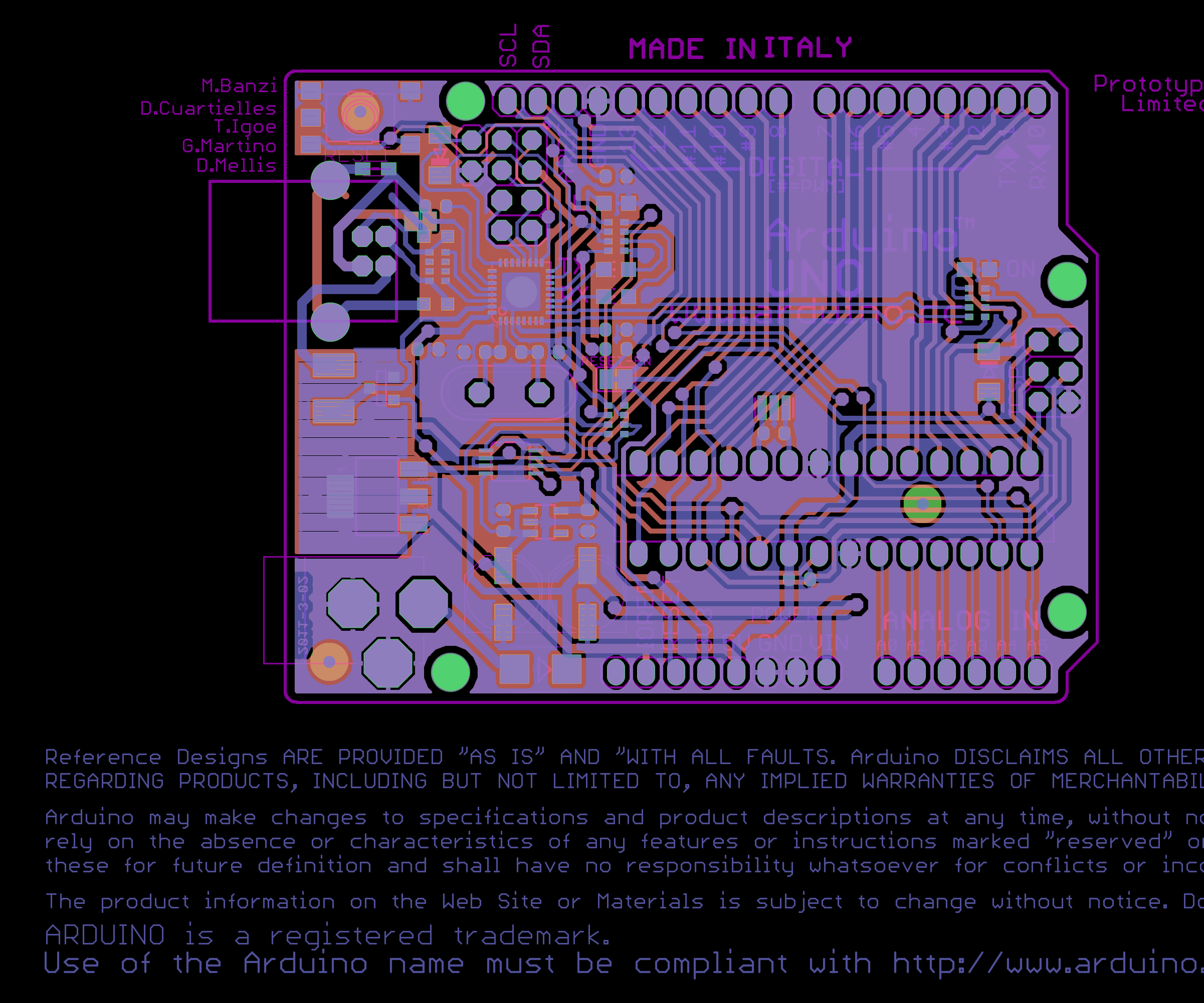

(You can now also see we I called it always Arduino Uno board. The main "Arduino" ATmega chip is disabled, we use other parts of the board here. This is also the reason why the pin is called TX; it is the main chips TX but UART/ATmega8U RX pin, confer the Arduino UNO Reference Design.)
