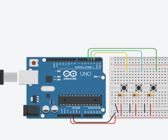

To do this, you'll need a Tinkercad account (open www.tinkercad.com) and use Google to sign up (makes things easier) or just sign up with your email. Let's get started!
I'll embed the circuit design here for reference. It is basic, but it isn't meant to be about electronics design but about interacting with various components using code features in Arduino.
