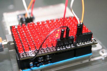

Step 2: Wire It Up
Attach the LOL shield to the Arduino.
Wire the Accelerometer as follows:
+3V
GND
X => A0
Y => A1
Z => N/C (Not Connected)
Note: The LOL shield does not come with Headers (as shown in the picture), attached to the topside.
I bought some here: http://www.amazon.co.uk/gp/product/B004RASBVY/ref=oh_details_o06_s00_i00

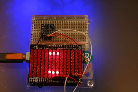

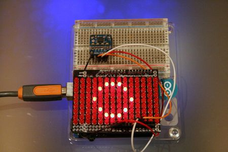

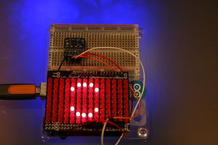

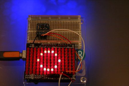

Notice that the circle is drawn in 4 quadrants. We illuminate 4 LEDs for each y we calculate.
The pictures show the steps to draw the circle as x iterates from 0 to RADIUS

for(int x = 0; x <= radius; x++) // x values from 0 to RADIUS (one Quadrant)
// solve r^2 = x^2 + y^2 for y
float y = sqrt(pow(radius, 2) - pow(x, 2));
y = round(y*1);
// Fill the y-position in the 4 quadrants of the circle
LedSign::Set(x + cx, y + cy, ink); // Quadrant 1
LedSign::Set(x + cx, cy - y, ink); // Quadrant 4
LedSign::Set(cx - x, y + cy, ink); // Quadrant 2
LedSign::Set(cx - x, cy - y, ink); // Quadrant 3

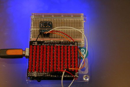

Step 6: Move the Circle by Tilting
Now we add the code to move the x,y position from the accelerometer readings.
As the accelerometer is tilted on its x any y axes its readings change.
The program first calibrates by measuring the at-rest readings of the accelerometer.
// Calibrate x and y values from Accelerometer
xAve = 0;
yAve = 0;
for (int i=0; i<8; i++) {
xAve = xAve + analogRead(A0);
yAve = yAve + analogRead(A1);
// Average x,y values correspond to "level"
xAve = xAve/8;
yAve = yAve/8;
Any deviation form these values is considered to be a tilt of the sensor.
// Calculate the Tilt away from "level"
// and draw the circle there
cx = cx0 + (xAve - analogRead(A0))/5;
cy = cy0 + (-yAve + analogRead(A1))/5;
The circle is drawn with centre at cx, cy:
DrawCircle(1); // DRAW the new circle
