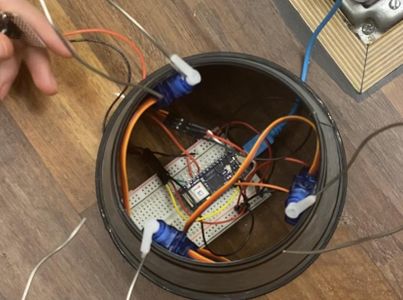

Step 1: Connect Your Microcontroller

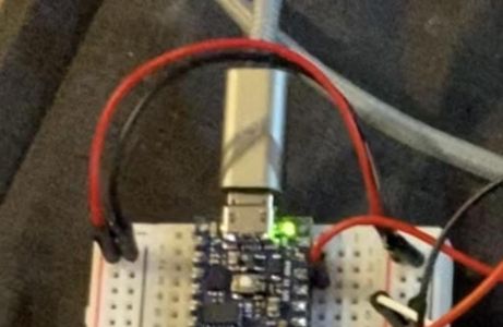

Make sure your microcontroller is stable on your breadboard and, using jumper wire, connect your power and ground on the microcontroller to the breadboard's power rails.
PRO TIP: For more secure connections, use coated solid core wire and cut it to a size where it can lay flat on your breadboard. Use red for power and black for ground. I didn't have black solid core wire so I used green. Solid core wire costs around $16. Link on Amazon: https://www.amazon.com/TUOFENG-Hookup-Wires-6-Different-Colored/dp/B07TX6BX47/ref=asc_df_B07TX6BX47/?tag=&linkCode=df0&hvadid=366430786295&hvpos=&hvnetw=g&hvrand=11252791347404772323&hvpone=&hvptwo=&hvqmt=&hvdev=c&hvdvcmdl=&hvlocint=&hvlocphy=9028818&hvtargid=pla-793870383734&ref=&adgrpid=75985294733&th=1
PRO TIP: Connect your power rails across your breadboard so you can access power and ground from either side.

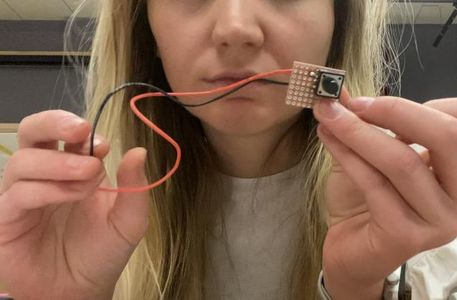

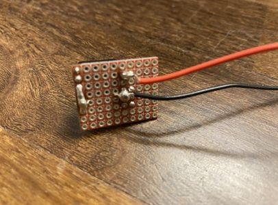

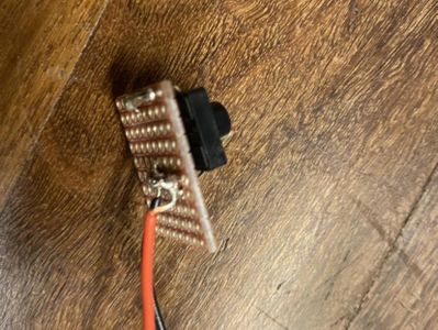

Step 2: Solder Your Pushbutton

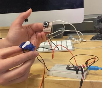

Break off a small piece of the breakout board and solder your pushbutton to it. You may need some help getting access to a soldering iron. I used multiple tutorials to figure this one out.
Here is a link to understanding pushbutton circuits: https://docs.arduino.cc/built-in-examples/digital/Debounce
Here is a link to soldering on prototype boards: https://www.youtube.com/watch?v=l9Kbr8cPqOE
PRO TIP: I was told that you don't need to add a resistor to your pushbutton circuit, just connect your power to a digital pin and ground to ground. The important part is debouncing your pushbutton in your Arduino code so that the loop doesn't try to read your button state too quickly, otherwise you will get unreliable readings.
Step 3: Connect Pushbutton to Servo
I followed this tutorial for connecting my pushbutton to a single servo motor, just to make sure I could get one working. Connect the red wire to your power, the brown wire to your ground, and the orange wire to a digital pin. You want to make sure that the servo motor can move to your desired angle (mine ended up being 60) after you push the button, and then move back to 0.
PRO TIP: Use the Serial monitor to get feedback from your button and motor.

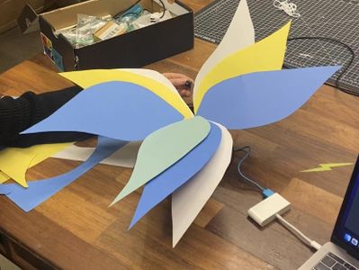

Step 5: Glue Servos to Lampshade and Attach Arms
Cut three pieces of sculpting wire about two finger-lengths each and hot glue them to your servo motor arms, bending the wire in a petal-shape. Hot glue your servo motors to the inside of your lampshade. Attach the servo arms with wire petals to your lampshade using hot glue. Test your servo motors again and adjust the arms so that they move out and in together.
PRO TIP: Make sure your wires are long enough that you can lift your lampshade up and ensure your connections are still good.

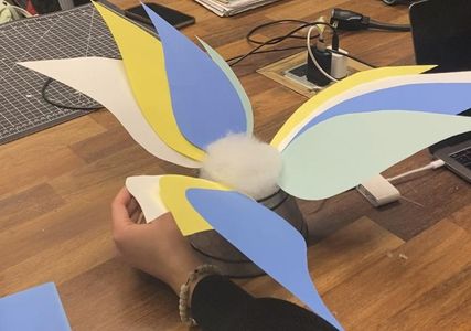

Step 6: Attach Petals
Cut out petals from construction paper in whatever shape you like. 3 petals for each arm of the servo motor should be glued together at the base. Use a loop of tape on the back of each petal arrangement to slide the petals onto the sculpting wire/servo arms. Make sure the loop is small enough that the petals are secured to the wire. Adjust the wire as needed. If you're having trouble with connections in your circuit, you can remove the petals and lift up your lampshade to see what's going on underneath.
PRO TIP: More glue at the base of your petals will help balance the weight of the construction paper toward the center.
Step 7: Add a Bit of Fluff
Some fluff in the middle will help conceal any wires sticking out. Push the button and breathe in as your flower closes, then breathe out as the flower opens back up again. It will be a little shake-y but that is ok! Just keep breathing.
PRO TIP: The fluff is unnecessary and will only get in the way of you being able to access your connections. I spray-painted my fluff outside and inhaled some toxic fumes, which gave me a headache. Then I became too anxious to share my work with others.
