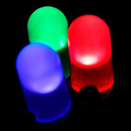

Step 3: RGB LED
This LED contains light emitting diodes. A red one, a green one and a blue one. Combining those into one LED will give you a RGB LED. You can all different kind of things with this LED.
