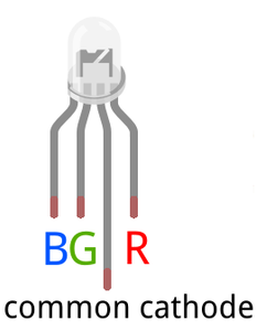

Now we have to connect RGB LEDs, but there are two types of RGB LEDs.
  1. Common anode LED
  2. Common cathode LED
Step 3: Building the Circuit
In this tutorial, I'm using a common cathode LED, so bend the tall lead (cathode pin) of the led and connect it to the GND terminal of the breadboard. Do the same for all RGB LEDs.
*For common anode LED circuit diagram and code should be different.
