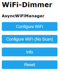

Step 2: WiFi Configuration
Once the code has been uploaded:
- open the WiFi connection utility.
- Find WiFi network “WiFi Dimmer” and connect.
- Open browser 192.168.4.1
- Configure Dimmer controller to home network access
