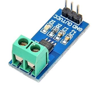

In this tutorial, we'll explore how to use the ACS712 Current Sensor with Visuino and Arduino to measure both AC and DC currents and display the readings in Amps on an OLED screen. The ACS712 is a Hall-effect-based sensor that provides accurate current measurements, making it ideal for various applications such as motor control and power monitoring.

Understanding the ACS712 Sensor
The ACS712 sensor comes in three variants, each designed for different current ranges:
  1. ACS712-05B: ±5A with a sensitivity of 185 mV/A
  2. ACS712-20A: ±20A with a sensitivity of 100 mV/A
  3. ACS712-30A: ±30A with a sensitivity of 66 mV/A
Choose the appropriate sensor based on the expected current in your application.

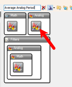

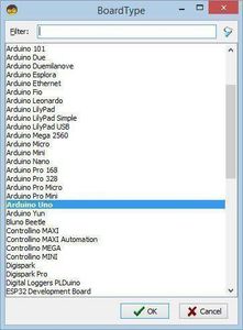

Step 3: Start Visuino, and Select the Arduino Board Type
Start Visuino as shown in the first picture Click on the "Tools" button on the Arduino component (Picture 1) in Visuino When the dialog appears, select "Arduino UNO" as shown on Picture 2
Step 4: In Visuino Add, Set & Connect Components
  1. Add "ACS712 Current Meter" component
  2. Add "OLED I2C" component
  3. Add "Start" component
  4. Add "Average Analog Period" component

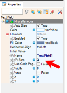

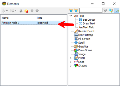

  1. Double click on the "DisplayOLED1" component and in the Elements window drag "Text Field" to the left side and in the properties window set "Size" to 3
  2. Close the Elements window

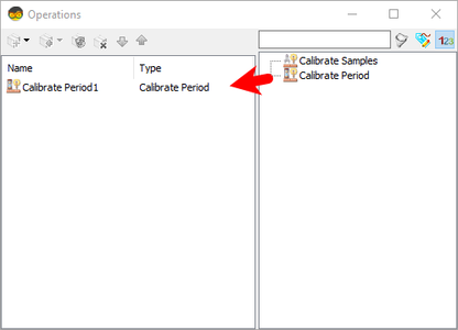

  1. Select "CurrentMeter1" and in the properties window set the type of your sensor by selecting "Range (A)" in this example we are using 20 (ACS712-20A)
  2. Double click on the "CurrentMeter1" and in the Operations window drag "Calibrate Period" to the left side and in the properties window set "Period (uS)" to 3000000, This means that on the start the sensor will calibrate it self for 3s
  3. Close the Operations window
