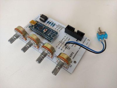

The hardware mainly consists of an arduino nano (ATmega328p) and a MPC4921 digital to analog converter.
As I said, pins are wired differently from the original project because I wanted the shield to be also compatible with arduino MCP492X library. This library is based on default SPI library and use those specific serial programming pins.
In particular (function, original project pin -> new pin)
/CS, 6 -> 10 (could be any pin, hardware design choice)
SCK, 5 -> 13 (nano SCK)
SDI, 4 -> 11 (nano MOSI)
/LDAK, 8 -> 9 (could be any pin, hardware design choice)
Gate In, 2 -> 8
Loop mode, 3 -> 2
The complete, simplified, wiring is schematized in the (shameful) attached image.
You can switch between loop mode and single envelope mode with a latching switch connected to D2_LOOP and ground; you can switch from a classic ADSR mode to a biased semi-inverted mode with a latching switch to D3_INV and ground.
Another slight hardware modification from the original project is the voltage limiter circuit to the gate input, the original being a 5.1 zener diode to ground. This one is instead based on two schottky diodes as per Doepfer notes.
Since version 0.2 I also overvoltage/inverse voltage protected the DAC output, just in case of an involuntary connection to another module's output that could potentially kill the DAC.
A hardware switch input to trigger the envelope has also been introduced here. It's a simple switch that pulls to +5V the gate input as far as it is kept pressed. Notice that to have this working even without a gate signal grounding the pin at rest, I had to add a pulldown resistor to the microcontroller gate input (D8). As an alternative approach, I could have assigned one of the already wired spare microcontroller pins for this function and solve with two additional lines of code, but it's a simple hardware modification and avoids cpu load so it was a no brainer.
Even if the shield is built around the original ADSRduino project, being open firmware we can thing at modifications/implementations to it. This is why I also wired 4 digital and 3 analog additional pins (all left unused in the original sketch), for future uses/sketches.
Note that all digital inputs (gate_in excluded) are not voltage protected, so if you will use them to input any control voltage from an external module not working in the 0 - 5 V range you should consider to add an external voltage protecting circuit.
Even if the board is equipped with a full 8x2 IDC connector, this projects is powered by +5V only.
Attention: The DAC output is only partially short circuit protected with a1K ohm resistor. During the insertion of a plug into the jack socket a short circuit between DAC out and GND is made for a short time. This is not a problem if the DAC out is at zero while patching (envelope "at rest"), but, worst case scenario, it could kill the DAC if loop mode is engaged or the envelope is triggered. The resistor should be enought to protect against shorts, anyway: at max output (+5V), we have a 5 mA current, but keep this in mind because a current limiting resistor is not effective as an opamp buffer would be.

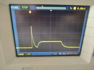

The envelope invertion coded is not exactly the ususal ADSR invertion, but what I should probably call a "biased semi-invertion". Works like this:
- Attack phase starts at maxium, positive value (+5V) and goes down to "zero" according to user defined velocity
- Decay starts at zero and drives to sustain level (not an inverted sustain level!)
- Decay starts from sustain leven and drives toward zero (not +5V).
All levels/times are set by acting on dedicated potentiometers.
It's "biased" since voltage is always in the 0 - 5V ballpark and doesn't go negative.
Attached images are actual non-inverted and semi-inverted biased envelope images and should clarify the biased semi invertion thing.

Well, yes and no. For what concerns the release driving toward +5V instead of 0V, there are no problems. It can be easily done with a couple of lines of code if you want to keep the semi-invertion option too, or even easier if you don't. Another story is having the envelope span the 0 to -5V range with the current hardware. This could be achieved with the addition of an opamp in inverting configuration at the DAC output, anyway.
EDIT: Github repository now hosts a new version of the sketch (ProgEnvGen_V1b.ino). Use a non latching switch/button in place of the latching switch connected to D3 to cycle between the ADSR modes: normal, biased semi-inverted and biased quasi-inverted. I called it "quasi" inverted because the sustain level still acts the usual way.

Hey: the silkscreen shows an ASDR envelope, not ADSR!
Glad you noticed it, yes, that's another "special" feature I will describe in a week or two because I have not the time now, must deal with climate changes, overpopulation and things like that, you know... nuclear holocaust eventually? Are you still reading? ehm ... ok. A feature is not. Sorry. What a fool. I moved without the needed attention the envelope phases names wrong during the n-th redistribution of components. Good eye anyway :)
Don't worry: the linked board has that error fixed (and some improvement too)!

Here is the list of components required to populate the PCB:
- 1X Arduino nano 328p
- 1X MCP4921 12 bit DAC
- 1X 8 pin IC socket
- 2X BAT42 Schottky diode
- 1X 8x2 IDC connector
- 4X 10K ohm potentiometers
- 3X 1000 ohm ressitors
- 1X 10K ohm resistor
- 2X latching switches
- 2X mono jack, female
The board is intended to be mounted perpendicular to the front panel. If your case is not deep enought, you can lock the board on the case bottom and use wires to gain electrical connection with elements (potentiometers, buttons, jacks and so on) on the front panel.
