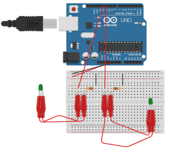

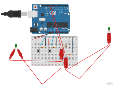

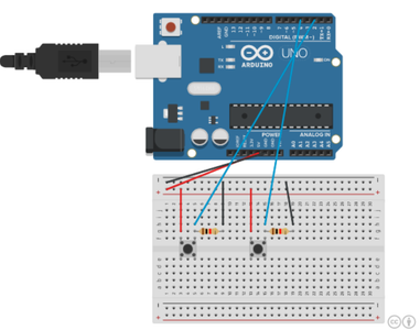

Step 1: Assembling the Circuit
Please assemble your components on the breadboard according to the pictures given. Note that you can change the pins of the LED and the tinfoil pads. In addition, you need 4 additional (male to female) jumper wires and 4 additional (male to male) jumper wires to connect your tinfoil pads to your Arduino board. In order to replace the button with jumper wires, you need to attach a (male to female) jumper wire to the spot below the 1K Ω resistor (blue) and another one spot block away from the first (male to female jumper wire). Repeat the steps above to replace another button with wires. As for the other wires which connect the tinfoil pads to the positive row, negative row, and the digital pin, attach them to the breadboard according to the pictures given. Next, you will need to attach the (male to male) jumper wires to the (male to female) jumper wires by plugging the male end of the (male to male) jumper wires to the female ends of the (male to female jumper wires. Repeat this step until every (male to female) jumper wire has a (male to male) jumper wire on top. After doing so, you will need to cut a piece of tinfoil from the roll you prepared in the previous step. (each approximately 9 cm in length and 6.5 cm in width) Attach the pieces of tinfoil that you cut and attach them to the (male to male) jumper wires by sticking the (male to male) jumper wires onto the tinfoil using transparent tape. However, do not use the same resistors when attaching the LEDs and the tinfoil pads. Instead, you should use the 1K Ω resistor for the tinfoil pads while using a 100-ohm resistor (Color code - brown black brown) for the LEDs.
