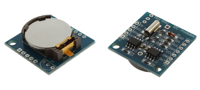

- AT24C32 / DS1307 real time clock ( I used the one on the picture above. There is also room for a temperature sensor like the LM35 on it)
