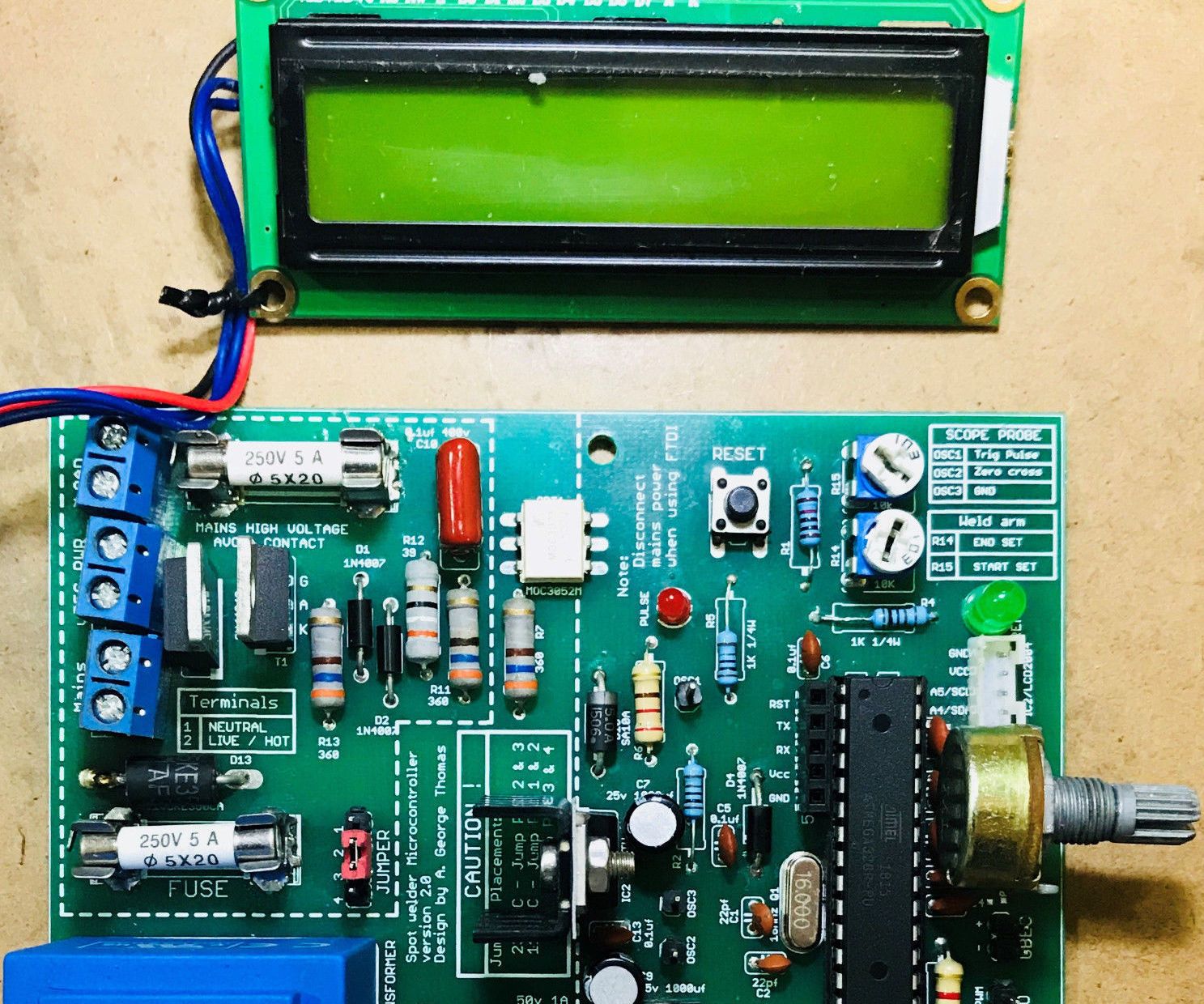

A Microcontroller built on the ATMEL ATmega328 chip. This controls how long the weld is done. The weld time are measured in milliseconds. When spot welding it is common as well as important that there be two welds, Why ? because the first weld clears the strip of all impurities that maybe stuck to it after production. The Second weld is when the strips melt and gets welded to the cell. The chip is powered by a regulated 5v supply from an on-board PCB transformer. The PCB works only on 240VAC, the Transformer can be replaced with a suitable 120VAC for the PCB to work in countries with 120VAC. Updater version, new design.

Step 1: The Assembled PCB
These days anybody can solder a PCB. Not very hard to learn either Grab the components from here. Always insert the ATMega chip at the end. Power up the PCB and if you see th POWER light lit, then GOOD JOB, you successfully soldered. Now you can insert the ATMega Chip.
