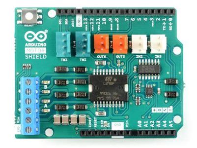

This driver supports Arduino Motor Shield V3 (basically any L298 driver) using bipolar stepper motors or ULN280x drivers using uni-polar stepper motors. The Arduino motor shield using L298 has hard-coded pins, but one is free to modify the source code if another L298 based board is used instead. As the documentation states, one must ensure all Arduino pins driving the stepper motor coils must be on the same AVR I/O port.

Motor drivers as shown above are supported. Other may require some code tweaks.
The Arduino Driver based on the L298 can drive bipolar (4-wire) stepper motors, the ULN2803 based driver can drive unipolar (5 or 6 wire) motors.

In case of Arduino motor shield: plug it on top of the Arduino. If different outputs or an ULN280x driver are used, one has to update the header file or even change the source code accordingly. The header file provides for various defines to select the kind of driver used and what Arduino pins control the motor coils / other driver pins.
In all cases, pins driving the coils must be AVR I/O pins belonging to the same I/O port. See the documentation for details: it lists Arduino pins vs. AVR ports.
